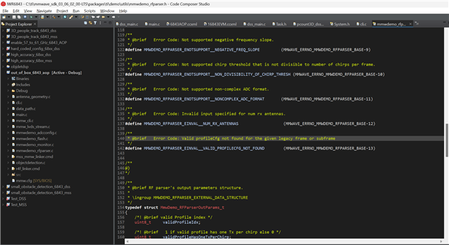

I am using the Hard coded config example to generate the chirp parameters. I used this GUI: https://dev.ti.com/gallery/view/mmwave/mmWaveSensingEstimator/ver/2.4.0/ to generate these parameters seen below.
I tried running this and keep getting this error code : Error: MmwDemo_RFParser_parseConfig [Error:-50013]
I found the error code means "Error Code: Valid profileCfg not found for the given legacy frame or subframe" seen in the image below.
I am a bit confused on what that means and what I should change in order to fix this. I will also attach the putty terminal and the console when the error occurs.
Please let me know any suggestions you may have. Thank you for the help.
