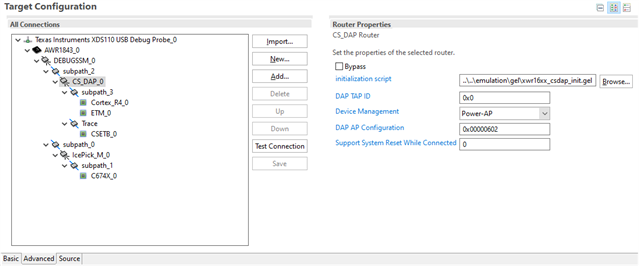

  • Hey Reem,
    I will need to pass this thread off to another engineer, but I have some last comments and suggestions as shown below.
    Regarding the -6305 error, could you open up your Target Configuration, click on the Advanced tab, and ensure that the CS_DAP_0 initialization script references xwr16xx_csdap_init.gel? This can be found under the following directory <CCS_VER_INSTALL_DIR>/ccs/ccs_base/emulation/gel. The image below shows how that might be referenced relative to the Target Configuration location.
    For the -1065 error, just to double check, you are loading the .xer4f file to the Cortex-R4F and not the C674x, correct? This error can occur if their is a mismatch in memory formatting and the .xer4f file.

  • Hi Kristien,
    Thanks for your reply.
    Luckily both errors were resolved and our two boards showed live data stream correctly in MRRvisualizer. It had something to do with the SOP switch setting. Maybe you could help me get this right. From the 1843boost user's guide as shown below, I thought I should use debug mode, not the functional mode. But only when the SOP is set for functional mode, it works fine. What are the usages of each mode, specially, debug mode?
    Also I'm just wondering at what step I need to resume when the board is powered off and switched back on again? I guess I do not need to flash the empty image (ti\utils\ccsdebug\xwr18xx_ccsdebug.bin) again. Should I start from "Launch target Configuration" or simply "Connect Target"?

  • debug mode is used with DCA1000.
    You do not need to flash the board again. You can change mode to functional and launch target configuration
    Please look through the guide for reset switch
