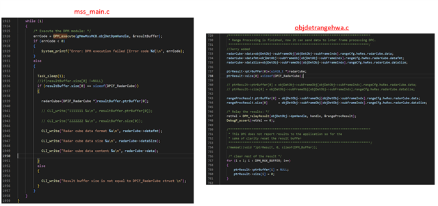

Good day~~ I simply want to extract the HWA range FFT data just before the data being injected into DSP part over MSS domain.

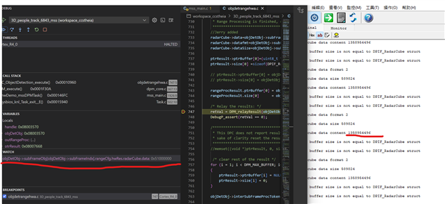

As below , I print out the HWA range FFT results through com port but  objDetObj->subFrameObj[objDetObj->subFrameIndx].rangeCfg.hwRes.radarCube.data
variable does not change over time. It keep showing 0X51000000 (1358954496). Why is that and what is this variable mean ?
On the other hand , if  we are unable to print out HWA range FFT data over MSS domain , how to get the data over DSS domain ?
I see there is a variable called  pDataIn which contains real and img part  of range FFT and is the input argument of  DPU_radarProcess_process function.
But  I couldn't print out  pDataIn through DSS domain using debug mode ( I use AWR6843AOP + MMWAVEICBOOST).
Is there a suggested way to extract this data ?
The part of code I modified is as below :
