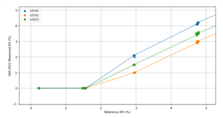

  • Good Morning,
    I am comparing the output from these sensors to a dew point sensor in the same system. Here is a plot of the results at the low end. The HDC3021 sensor output is on the y axis and the reference is on the x axis. The three sensor return 0 RH at 1.5% RH and are between 1 and 2 % RH low on the rest of the measurements.
  • Hello Harrison,
    What is the desired RH%? Are you wanting to match LO103 to LO101 or LO102?
    Meredith McKean
  • The desired is the reference RH shown on the x axis. The reference comes from a separate dew point sensor. ideally all three would match the reference.

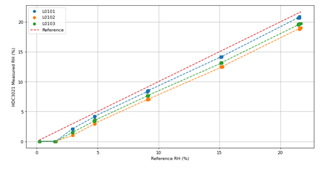

  • Hello Harrison,
    Can you provide the plot that you provided with more data points? I want to see the full offset of the device. I see that you have provided an excel sheet with PPMv and the reference humidity. Can you provide those values in relative humidity (RH%)?
    Meredith McKean
  • Yes here is the full plot of all test points, I also included the reference line on the plot to get an idea of offset.
    Regarding the excel file, that was meant more to just be a quick test on RH response based on temperature to answer your above question. The humidity was likely not uniform throughout the three sensors at the start of the test. By the end it should be uniform. I also did not record a true reference RH measurement, only the ppmv. I can provide a close approximation using the temperature measured at each sensor and assuming 1 atm pressure. Calculated references are attached for each sensor, as well as what the raw output from 103 would have been.
