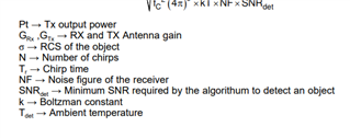

I am currently working with the AWR1642 radar and aiming to increase the detection range to approximately 200 meters, targeting a vehicle (RCS ≈ 10 m²).
Based on the technical documentation and TI forum discussions, it seems that increasing the number of chirps per frame (N = 256 or N = 512) could help improve the SNR, and thereby extend the range, without modifying the hardware.
Could you please confirm if increasing the number of chirps to 256 or 512 is a recommended approach for Long Range Radar (LRR) applications with the AWR1642?
Are there any specific limitations (such as processing time or memory usage) that should be considered with such configurations?
