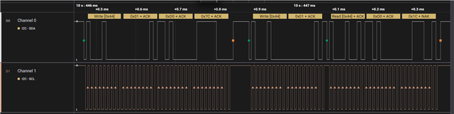

Hello, I am working in implementing the OPT3004 Ambient Light Sensor to the firmware of an ESP32-S3.
I was able to establish I2C connection reading the values of all registers just fine. However, when trying to change the configuration register it doesn't take effect.
Here is a picture of the logic analyzer when writing and then reading the configuration register:
The image doesn't have the best resolution for some reason, here is the data of the image:
Write 0x44 0x01 0xD0 0x7C
Then, the read procedure is: Write 0x44 0x01 Read 0x44 0xD0 0x1C,
Here is the code of my implementation when configuring:

Here is the logged data of the ESP32-S3 firmware when interacting with the OPT3004:
I (8505) OPT3004: opt3004_init - Initializing OPT3004
I (8575) OPT3004: opt3004_init - Manufacturer ID: 5449
I (8615) OPT3004: opt3004_init - Device ID: 3001
I (8625) OPT3004: opt3004_init - Config register D01C
I (8635) OPT3004: opt3004_init - Configuration
I (8635) OPT3004: opt3004_init - Range: Automatic
I (8645) OPT3004: opt3004_init - Convertion time: 800ms
I (8645) OPT3004: opt3004_init - Convertion mode: Shutdown
I (8655) OPT3004: opt3004_init - Latch: Transparent Hysteresis
I (8655) OPT3004: opt3004_init - Polarity: Active High Interrupt
I (8665) OPT3004: opt3004_init - Exponent: No change to exponent value of register
I (8675) OPT3004: opt3004_init - Fault count: 8 faults
I (8675) OPT3004: opt3004_init - Flag high: 0
I (8685) OPT3004: opt3004_init - Flag low: 0
I (8685) OPT3004: opt3004_init - Convertion overflow: 0
I (8685) OPT3004: opt3004_init - Convertion ready: 0
I (8695) OPT3004: New Config D07C
I (8705) OPT3004: opt3004_init - New config Read D01C
I (8705) OPT3004: opt3004_init - Sensor OPT3004 initialized
I'm not sure what to do in order to change the conversion mode from "shutdown" to "continuous".
I hope you can help me figure out what is causing this issue.

  • Welp, the issue was the union I used to parse the config data, I had the same problem when parsing the result data. Here is the snippet with both union corrected:
    typedef union{
      uint16_t reg;
      struct{
        uint16_t fraction:12;
        uint16_t exponent:4;
      } bytes;
    } opt3004_reg_t;
    typedef union{
      uint16_t conf;
      struct{
        uint16_t fault_count:2; // R/W number of faults to trigger interrupt 00:1 fault 01:2 faults 10:4 faults 11:8 faults
        uint16_t mask_exponent:1; // R/W 0:no change to exponent value of register 1:changes the value of exponent to 0000b when range is manually selected
        uint16_t polarity:1; // R/W 0:active low 1:active high
        uint16_t latch_field:1; // R/W 0:interrupt with no user-controlled clear 1:interrupt with user-controlled clear
        uint16_t flag_low:1; // R 0:light above low threshold 1:light below low threshold
        uint16_t flag_high:1; // R 0:light below high threshold 1:light above high threshold
        uint16_t conversion_ready:1; // R 0:conversion not ready 1:conversion ready
        uint16_t overflow:1; // R 0:light between selected scale 1:light exceeds selected scale
        uint16_t conversion_mode:2; // R/W mode of conversion 00:shutdown 01:singleshot 10-11:continuous
        uint16_t conversion_time:1; // R/W time for conversion 0:100ms 1:800ms
        uint16_t range_num_field:4; // R/W full scale range selection
      } bits;
    } opt3004_conf_t;
    It's all about the endianess of the bytes, the sensor sends MSB First and the ESP32-S3 firmware works with LSB First....
    Also, I had a bit of an overflow destroying the data buffer in the read operation:
    *res = ((uint16_t)result[0] << 8) | result[1];
    I wasn't casting the "result[0]" to uint16_t, which destroyed the entire buffer for some obvious reason.
