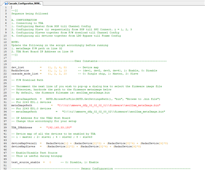

I’m following all the steps mentioned in the mmwave_studio_cascade_user_guide. In the SensorConfig tab, I’m running the following Lua script:
C:\ti\mmwave_studio_03_00_00_14\mmWaveStudio\Scripts\Cascade\Cascade_Configuration_MIMO.lua

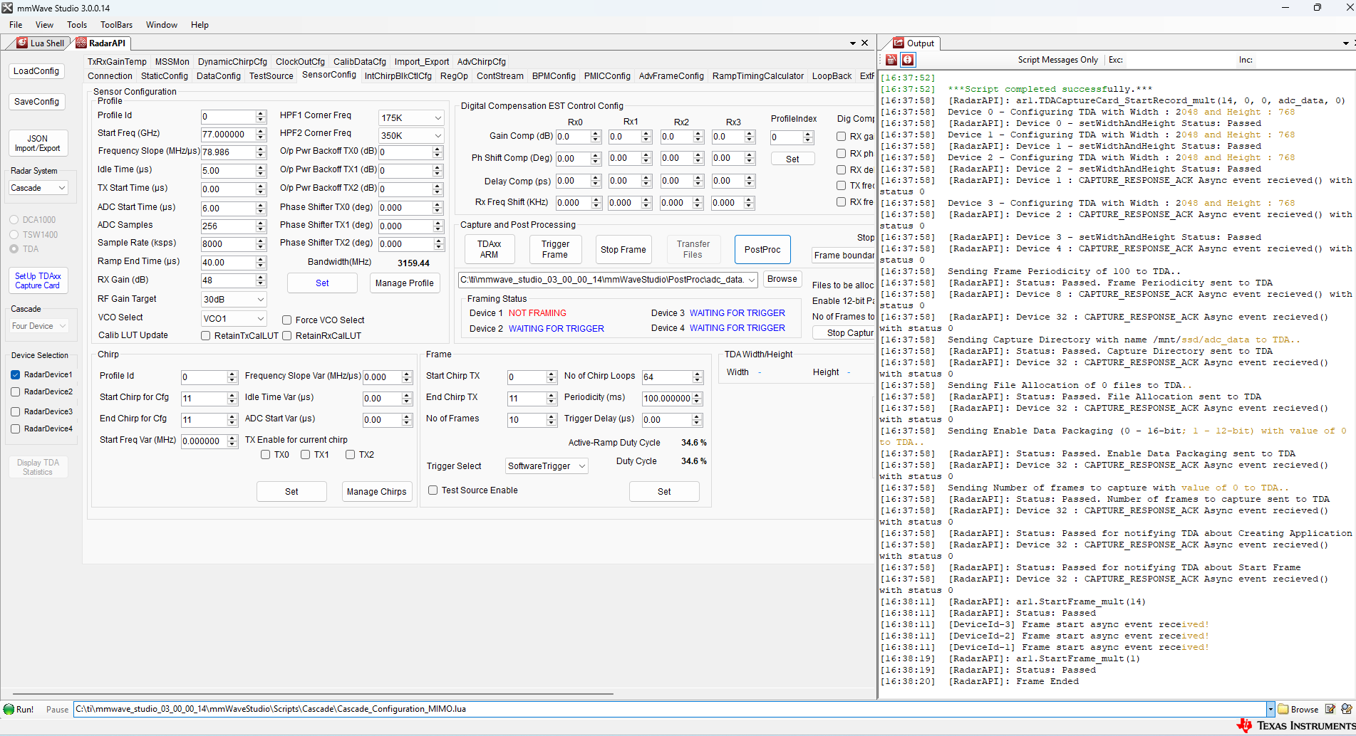

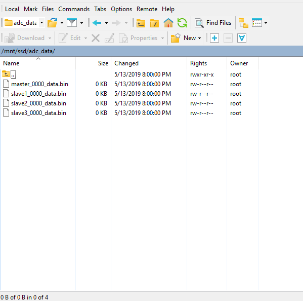

However, after triggering the frames (Hardware for slaves and software for the master at the end), the captured data size is zero. Could you please help me identify what might be causing this issue, or if I’m missing any step?
Thank you for your assistance.

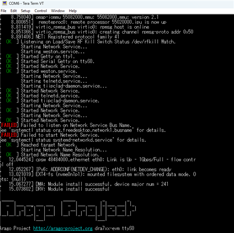

    Thank you for your response. I believe the connection to the TDA board is accurate. I ran the script located at C:\ti\mmwave_studio_03_00_00_14\mmWaveStudio\Scripts\Cascade\Cascade_Configuration_MIMO.lua, and it completed without any errors.
    After modifying the parameters as mentioned, I executed the script C:\ti\mmwave_studio_03_00_00_14\mmWaveStudio\Scripts\Cascade\Cascade_Capture.lua, but I encountered a connection error.
    Please find the attached photo and log file.

    [16:50:16]  Loops Remaining : 1
    [16:50:16]  Starting TDA ARM...
    [16:50:16]  [RadarAPI]: ar1.TDACaptureCard_StartRecord_mult(1, 0, 0, mimo_10, 100)
    [16:50:16]  Device 0 - Configuring TDA with Width : 2048 and Height : 768
    [16:50:16]  [RadarAPI]: Device 0 - setWidthAndHeight Status: Passed
    [16:50:16]  [RadarAPI]: Device 1 : CAPTURE_RESPONSE_ACK Async event recieved() with status 0
    [16:50:16]  Device 1 - Configuring TDA with Width : 2048 and Height : 768
    [16:50:16]  [RadarAPI]: Device 1 - setWidthAndHeight Status: Passed
    [16:50:16]  [RadarAPI]: Device 2 : CAPTURE_RESPONSE_ACK Async event recieved() with status 0
    [16:50:16]  Device 2 - Configuring TDA with Width : 2048 and Height : 768
    [16:50:16]  [RadarAPI]: Device 2 - setWidthAndHeight Status: Passed
    [16:50:16]  [RadarAPI]: Device 4 : CAPTURE_RESPONSE_ACK Async event recieved() with status 0
    [16:50:16]  Device 3 - Configuring TDA with Width : 2048 and Height : 768
    [16:50:16]  [RadarAPI]: Device 3 - setWidthAndHeight Status: Passed
    [16:50:16]  [RadarAPI]: Device 8 : CAPTURE_RESPONSE_ACK Async event recieved() with status 0
    [16:50:16]  Sending Frame Periodicity of 100 to TDA..
    [16:50:16]  [RadarAPI]: Status: Passed. Frame Periodicity sent to TDA
    [16:50:16]  [RadarAPI]: Device 32 : CAPTURE_RESPONSE_ACK Async event recieved() with status 0
    [16:50:16]  Sending Capture Directory with name /mnt/ssd/mimo_10 to TDA..
    [16:50:16]  [RadarAPI]: Status: Passed. Capture Directory sent to TDA
    [16:50:17]  Sending File Allocation of 0 files to TDA..
    [16:50:17]  [RadarAPI]: Status: Passed. File Allocation sent to TDA
    [16:50:17]  [RadarAPI]: Device 32 : CAPTURE_RESPONSE_ACK Async event recieved() with status 0
    [16:50:17]  Sending Enable Data Packaging (0 - 16-bit; 1 - 12-bit) with value of 0 to TDA..
    [16:50:17]  [RadarAPI]: Status: Passed. Enable Data Packaging sent to TDA
    [16:50:17]  Sending Number of frames to capture with value of 100 to TDA..
    [16:50:17]  [RadarAPI]: Status: Passed. Number of frames to capture sent to TDA
    [16:50:17]  [RadarAPI]: Status: Passed for notifying TDA about Creating Application
    [16:50:17]  [RadarAPI]: Status: Passed for notifying TDA about Start Frame
    [16:50:17]  TDA ARM Successful
    [16:50:18]  Starting Frame Trigger sequence...
    [16:50:18]  [RadarAPI]: ar1.StartFrame_mult(8)
    [16:50:18]  [RadarAPI]: Status: Passed
    [16:50:18]  Device 4 : Start Frame Successful
    [16:50:18]  [RadarAPI]: ar1.StartFrame_mult(4)
    [16:50:18]  [DeviceId-3] Frame start async event received!
    [16:50:18]  Device 3 : Start Frame Successful
    [16:50:18]  [RadarAPI]: ar1.StartFrame_mult(2)
    [16:50:19]  [DeviceId-2] Frame start async event received!
    [16:50:19]  [RadarAPI]: Status: Passed
    [16:50:19]  Device 2 : Start Frame Successful
    [16:50:19]  [RadarAPI]: ar1.StartFrame_mult(1)
    [16:50:19]  [DeviceId-1] Frame start async event received!
    [16:50:19]  Device 1 : Start Frame Successful
    [16:50:19]  Capturing AWR device data to the TDA SSD...
    [16:50:19]  [DeviceId-0] Frame start async event received!

    Yes, I completed the IP configuration, and I am able to ping from the PC. The error happens when I start to capture data.
  • In Tetra Term I have some FAILED, are they reason of this problem?
