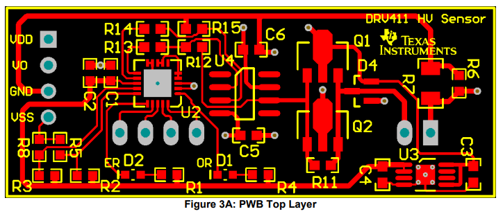

    Finally, can you check any reference schematic and payout for my customer? I cannot find anything on TI.com.
    Chase
  • Hello Chase,
    Thank you for your patience with me catching up on this.
    I would say the best starting point would be the layout and schematic shown in ±100 A Closed-Loop Current Sensor Reference Design
    This will be a good starting point and then we can tweak values accordingly.
