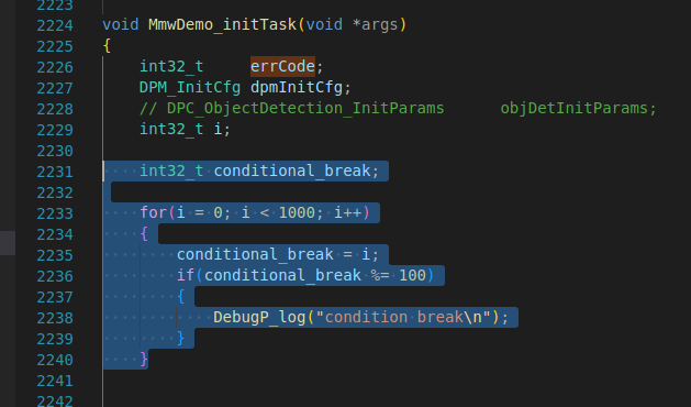

modify based on high end corner radar
radar_toolbox_3_30_00_06/source/ti/examples/Automotive_ADAS_and_Parking/high_end_corner_radar/src/demo/awr2x44p/mss/mss_main.c
Add a variable conditional_break, the if and debug log is used to avoid auto optimization by compiler
add breakpoint where you want it:
right click the breakpoint and select breakpoint property
add a condition like this:
continue program and breakpoint hit when the condition_break becomes 200
For ccs 20.3.1 I did similar test and it also works. The first breakpoint is not hit and the second breakpoint is hit when condition_break is set to 200.
