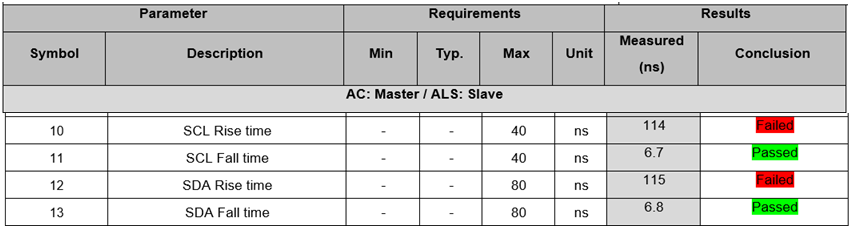

My customer is using this part in display project, OPT3001 shared I2C with backlight driver, structure as below:
They tested rising time for SCL and SDA, results as below:image.png
The rising time exceeds the limits in the datasheet:
Is there any risk, do you have any recommendations?
