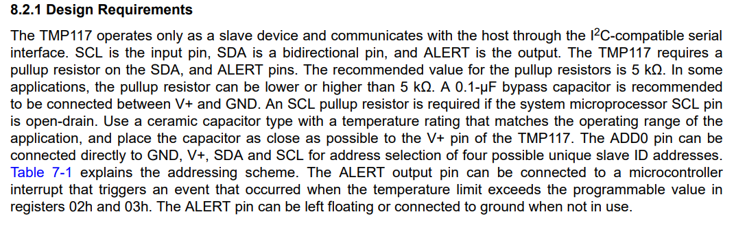

The TMP117 specifies that a pull-up resistor is required when using the SCL pin as an open-drain output.
Do different temperature sensors conforming to the same I2C standard have different requirements?
TMP101: I²C specification for multi-master (multiple master devices)? Cross-stretch compatible? (Possibility of SCL port becoming an output port?)
TMP117: I²C specification for both multi-master (multiple master devices) and single-master (one master device)? Cross-stretch incompatible?

  • Pull-up is not required at SCL.
    Assuming timing and logic level parameters are met, I don't see a reason for the SCL input to interact with a pull-down resistor.
    The TMP101 and TMP117 are not different in this regard. The SCL is only an input on both devices. The text is describing a typical application. Pull-up resistors are a normal feature of the I2C bus.

  • I assume your SCL driver is push-pull. It would have to source current to create logic high when there is no pull-up resistor present. Open drain drivers require pull-up resistor to create logic high. The I2C bus is defined as open-drain (as opposed to push-pull) so that it can be shared by both controllers and targets safely. The TMP products cannot act as controllers. The TMP products are only I2C targets. It's for this reason that their SCL pins are input-only, and their SCL pin can safely share the bus with a push-pull driver on the SCL pin only.
