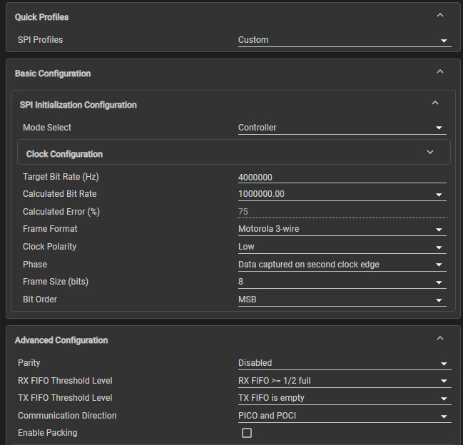

SPI Configuration:
  • MCU configured as SPI Master, TDC1000 as Slave
  • SPI Mode & SPI Clock Frequency: Screenshot is attached for reference
  • Data width: 8 bits
  • CS is active low and controlled via MCU GPIO
  • EN is set high and RESET is toggled low→high before SPI access.
    For SPI read, CS is pulled low, register address is sent, and dummy bytes (0x00) are clocked to read data.

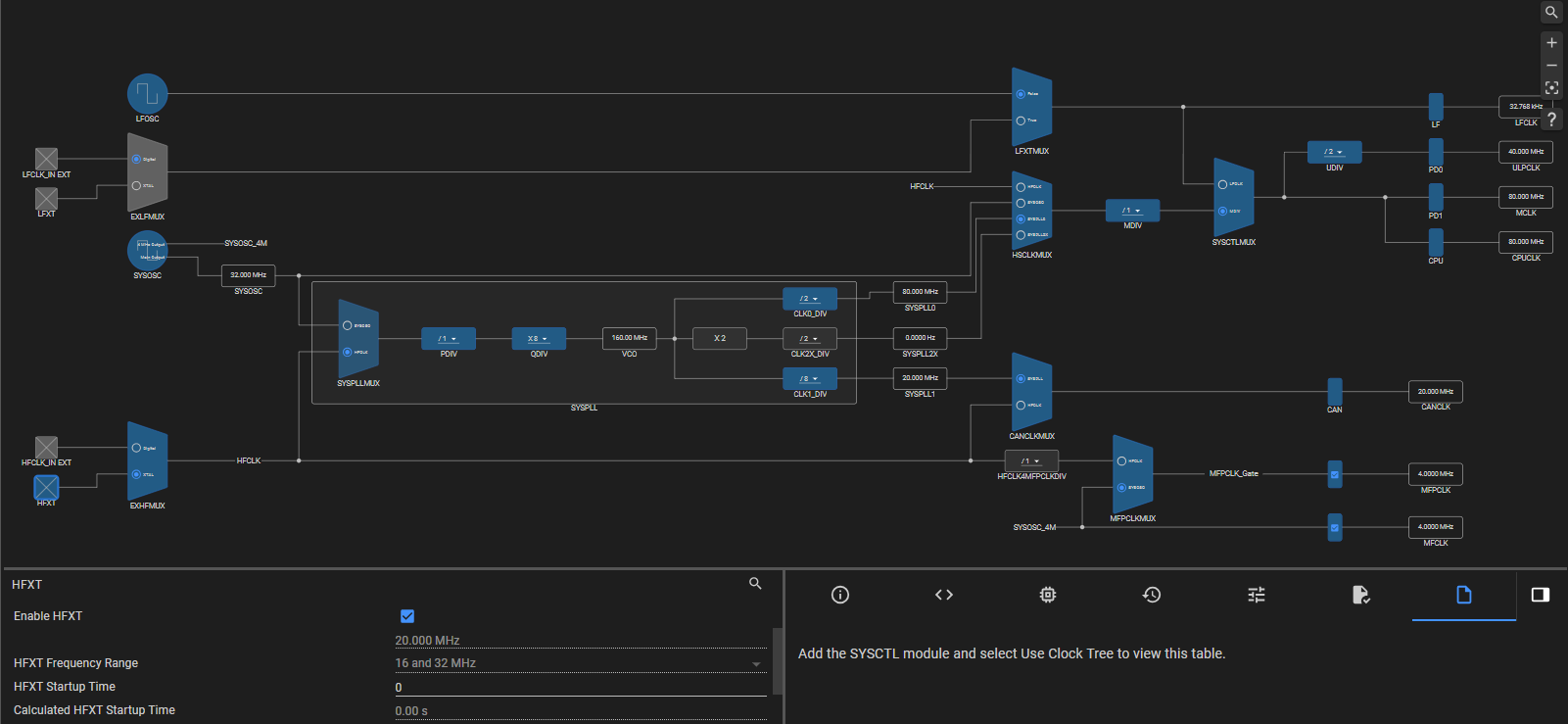

Clock Configuration:
  • Attached MCU clock tree configuration for reference.

    Based on your signal, it looks like for a single transfer, the clock stops after 8-bits. Could you try increasing the frame size to 16-bits to see if that helps?
    I have included an example of what a read of register 0x03 from the TDC1000-C2000EVM looks like below:
    The settings that the EVM + GUI use for clock polarity is CPOL = 0 (clock is low when active) and clock phase is CPHA = 0 (data is valid on clock leading edge).
