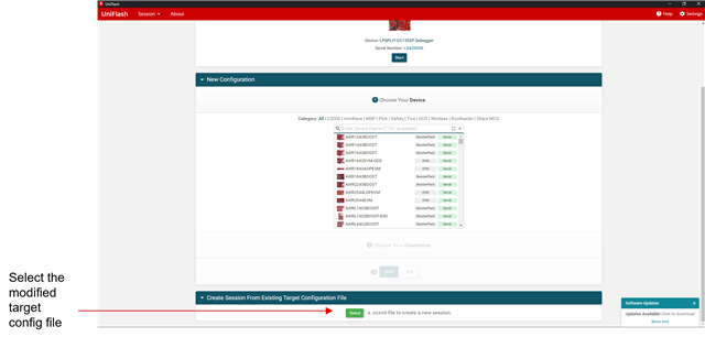

I am trying to flash firmware to PGA900/970, and I am getting a data verification error. I have verified my hardware connection.
  • Please review the information in this thread for using Uniflash:  [FAQ] PGA900: How do I flash firmware to PGA900/PGA970?
    Data verification errors occur when Uniflash or CCS is unable to load the image to the PGA.

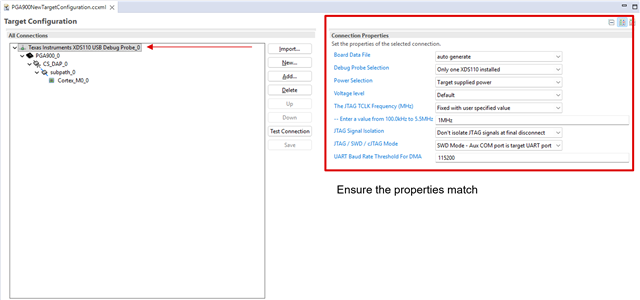

    If you are creating your own Target Configuration file, make sure the settings match below:
    Additionally, the .gel file path needs to match in the .ccxml file (the Target Configuration file) and the PGA900 .xml file:
    When you open Uniflash, you will select the .ccxml file you just modified:
