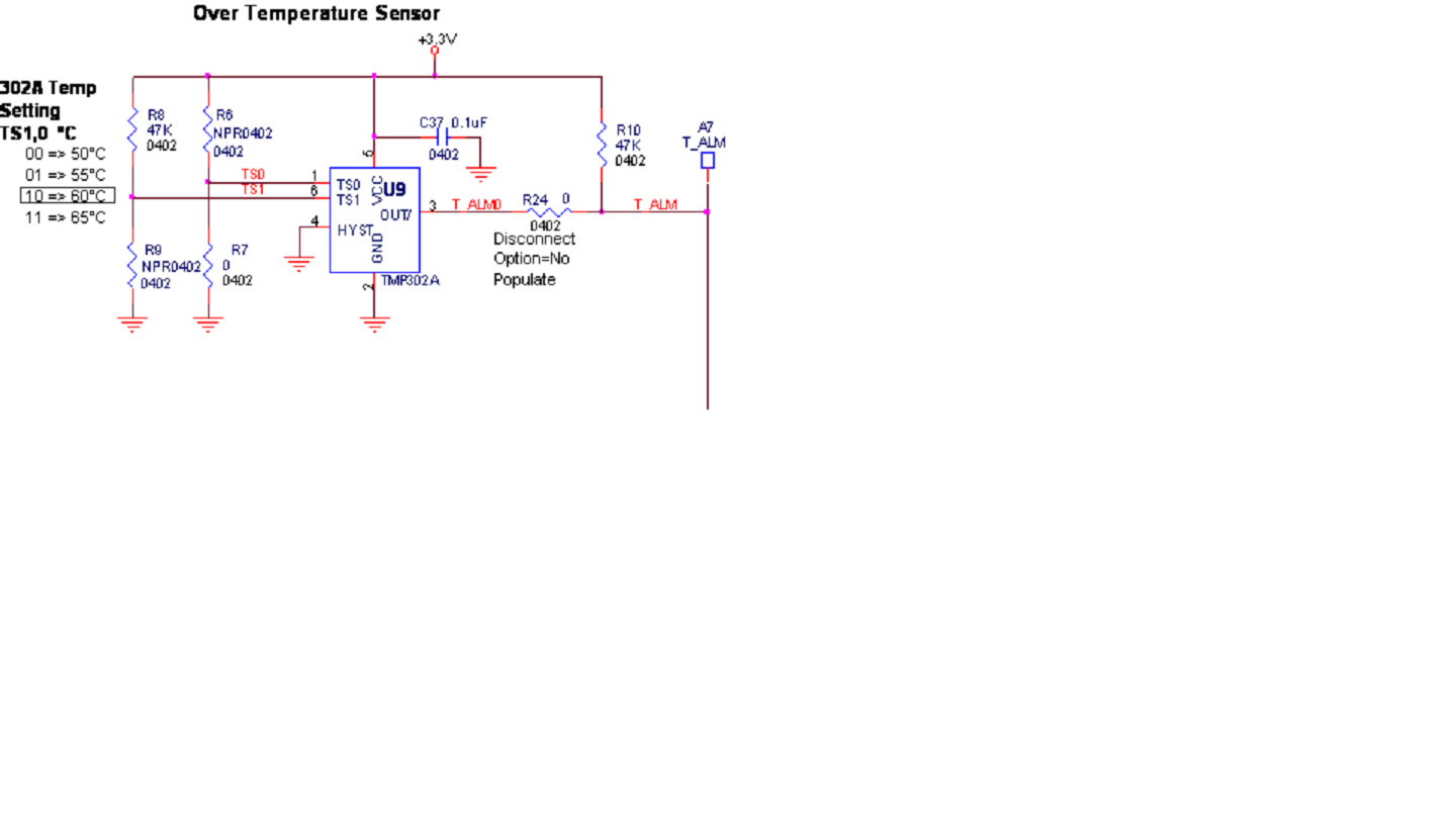

Can you please give the recommended pullup/pulldown resistance values for the TMP302A TS0 and TS1 setting inputs?
We are using a 47K pullup to VCC for the TS1 line, and 0 Ohm pulldown to GND for TS0 expecting a 60 Deg C trip, but seem to be tripping at 50 Deg C.
