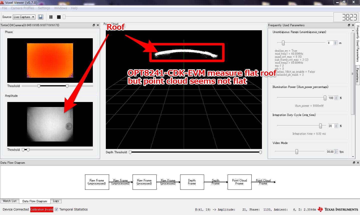

When I use OPT8241-CDKEVM with TintinCDKCameraLongRange.conf a point cloud seems bent.
Attached file shows point cloud when OPT8241-CDK-EVM measure flat plane, a point cloud seems bend like semi circle shape.
From my understands it cause from lens distortion. But TintinCDKCameraLongRange.conf includes OpenCV lens distortion correction parameter.
Could you tell me why point cloud bent?
I know that I can get good point cloud if I use calibrated configuration. but I want to know more bit detail.
  • Hi
    If you see the bottom left corner of the image, you can notice the warning(highlighted in red) saying calibration invalid. This indicates that either a non calibrated profile is used or a parameter is changed which affects calibration. In your case, you have used TintinCDKCameraLongRange.conf which is not calibrated. Kindly use  the calibrated profile TintinCDKCameraMetrilusLongRange.conf and this problem will disappear.

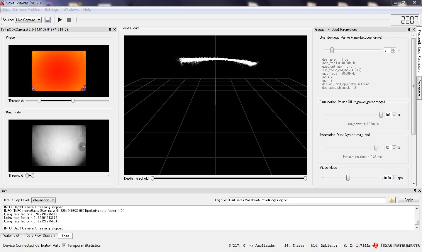

    Point cloud is bent because of common phase offset which you can calibrate with the help of voxel viewer
    Thanks and regards
    Nithin
  • Thanks for reply
    I tried common phase offset calibration with VoxelViewer. but point cloud seems still bent.
    From my understand : "common phase offset calibration" will fix offset of common to all of the pixels.
    so common phase offset calibration will not change point cloud shape. it makes point cloud move to parallel.
    I think I must try pixelwise phase calibration to fix point cloud shape.
    Is my understand correct?
  • Suzuka san,
    It is true that changing the constant phase offset will change the offset of each of the pixels to the same value. However, you can observe that between the 2 images you have shown us, the second image with corrected phase offset has better flatness. This happens because phase offset corrects the radial distance in spherical coordinates. A flat wall has different values for 'r' at each pixel. So when you introduce a constant offset in the radial distance, it can look curved.
    Speaking of this in more mathematical terms, a flat wall is not defined by a set of linear equations in spherical coordinates. So changing a given parameter might affect the shape in a "curved" manner instead of having a simple linear translation effect.
    Assuming the camera is showing the distance at the center accurately, you should now be able to correct the remaining bending in the flat wall shape by doing pixelwise phase correction.
