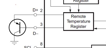

  • Hi SHH,
    Page 14 of the datasheet recommends a 3904 type of remote diode. Other transistors can be used but that is most common. Page 14 also describes the type of transistors that can be use:
    If a discrete transistor is used as the remote temperature sensor with the TMP401, the best accuracy can be
    achieved by selecting the transistor according to the following criteria:
    1. Base-emitter voltage > 0.25 V at 6 μA, at the highest sensed temperature.
    2. Base-emitter voltage < 0.95 V at 120 μA, at the lowest sensed temperature.
    3. Base resistance < 100 Ω.
    4. Tight control of VBE characteristics indicated by small variations in hFE (that is, 50 to 150).
    Based on these criteria, two recommended small-signal transistors are the 2N3904 (NPN) or 2N3906 (PNP).
    If a transistor different than the 2N3904 is used then you should also get the n-factor specification of the device from the manufacturer so you can compensate the differences between that device and the 2N3904 as described in the datasheet on page 4:
    The ideality factor (η) is a measured characteristic of a remote temperature sensor diode as compared to an
    ideal diode. The ideality factor for the TMP401 is trimmed to be 1.008. For transistors whose ideality factor does not match the TMP401, Equation 1 can be used to calculate the temperature error. Note that for Equation 1 to be used correctly, actual temperature (°C) must be converted to Kelvin (°K).

  • Hi SHH,
    Sorry for the delay. It looks like the transistor you picked is a 3904 type as the specs are identical to that of other manufacturers. It should work fine I believe. As a check though you should test it to make sure that the:
    You should ask the manufacturer if:
