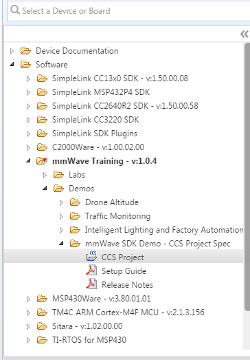

    As the new sdk version is released, my customer want to get the relative mmw demo ccs project.In the TI resource explorer seems the project is still for SDK 1.05, where can I find the ccs project for SDK 1.1.02?
    Another question is that if open the resource explorer in ccs view->resource explorer as below figure, the mmwave training package is not updated to the latest version even i download the new mmwave training package 1.4.3 and stored it in folder c:/ti, close and reopen the ccs the packages is still not updated to 1.4.3. Would u pls let me know how to update the mmwave training package in ccs resource explorer?
