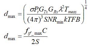

I was curious as to how mmWave Sensing Estimator is calculating the maximum range?
I am entering the following parameters in mmWave:
To keep it simple, I am using 1 TX and 1 RX antenna with 0 losses.
I realize that maximum distance is dependent on  the radar range equation and the slope/IFfreq equations:
Using the 2nd equation, I can get the desired range of 70 with the chirp parameters: S = 7.21MHz/us and Fif = 3.36MHz.
What I don't understand is how the "Max Range for Typical Detectable object" of 84.61m is calculated?
I am using the radar range equation with:
RCS = 5
Pt = 12 dBm =0.0158W
Gtx = Grx = 9 db = 7.94
wavelength = 3.95mm
Tmeas = number of chirps * Chirp duration = 65 * 55us
SNRmin = 12 dB = 15.85
Temp = 293K
F = 16 dB = 39.81
Bandwidth = 5MHz
This only results in 1.5m which is of course not correct.
1) I am curious as to how Tmeas is calculated? Isn't it just number of chirps x chirp time?
2) How is the bandwidth calculated? Would it just be the IF bandwidth?
