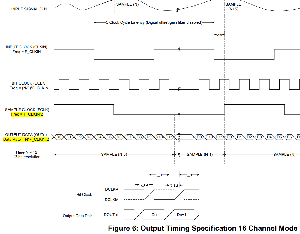

Hi team,
    My customer has some question about the IC, Could you give him some advice?
1.   NM1~INM16 are NC ,should I connect them to ground or VCC with a resistance?
2、ADC_CLKP &ADC_CLKN are LVDS, Should I add a 100 ohm to short out?
3、In datasheet(Rev 0.5  Mar/2015  )P113  Figure38   VREF_IN_REXT is connected with a cap ,Why do this ? And I don't find the Pin. As the yellow part:
4、Is DGND apart from AGND? AVSS1.8V is apart from DVSS1.8V? Do you have some recommendation about  decoupling capacitor?
5、FCLK & OUTPUT DATA have wrong position? Is FCLK equal to F_CLKIN? Is Data Rate equal to N*F_CLKIN ?
