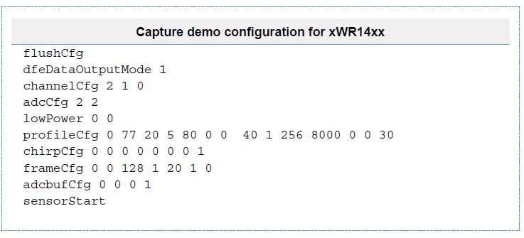

I am trying to do capture demo, from the guide mmwave_sdk_user_guide.pdf
I don't know how to command to CLI window as the section 3.4.2 Capture Demo for AR14xx step 3. Can you teach me ? Thank you.

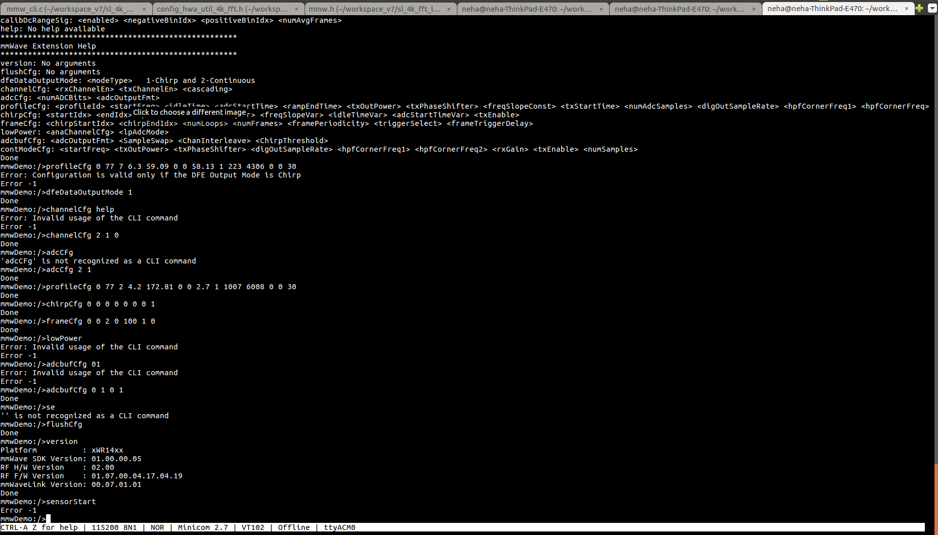

Hi Raghunandan,
I am using IWR1443BOOST board. Using the Configurations in the demo i tried to interact with my board. But the sensorStart command gave me error saying "Error -1" as can be seen in the screenshot below. Can you please tell me how do i debug the error. Also i wanted to know how will i know what is causing the error. Is there any Manual or user guide of sorts for the CLI? The help command isn't of much help.
Neha
Hi Akash!
The issue was probably with the validity of the profile. But i had acquired the above profile from the estimator. I tried with a slightly different profile and it worked.
