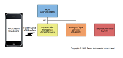

    I have found a TI design that might help you. The engineers use an analog output IC temperature sensor. In this design, the temperature is measured with the analog temperature sensor that interfaces with an analog-to-digital converter (ADC). After the temperature data is digitized, the data is sent to the MSP430G2403 microcontroller which stores the data and then sends it to the RF430CL330H NFC transponder. The RF430CL330H bundles the data into the NFC protocol and sends it to a NFC reader.
    http://www.ti.com/lit/ug/tidubt8/tidubt8.pdf
    In your application, you will need to amplify your 3mV voltage to meet the input range of the ADC. The ADC will digitalize your signal and send the data to the microcontroller (you might be able to find a MCU with an embedded ADC). The data will be stored on the micro built in memory and then send it to the NFC transponder via I2C communication.  All this requires will require experience with microcontroller programming.

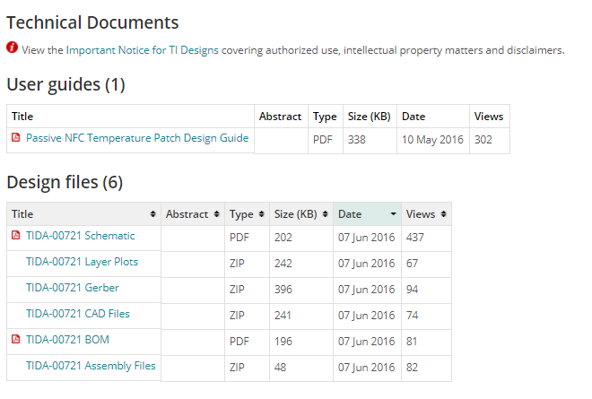

  • In addition,
    I want to say that the TIDA-00721 Module is not available for purchase/order. Can you please tell me about its availability ?
    Thanks and Best regards,
  • Hi Ahsan,
    I am glad was explanation was helpful!
    Not all our reference designs are available for sale. This one is not available for purchase but we are sharing all design files with you so you can reproduce the design.
