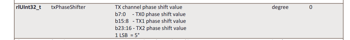

In BPM-MIMO,, Can these phases be only 0º and 180º ? Can these phases be 45º , 135º or others?
Hello ,
The phases in BPM-MIMO can only be 0 and 180. We cannot have any other phase.
