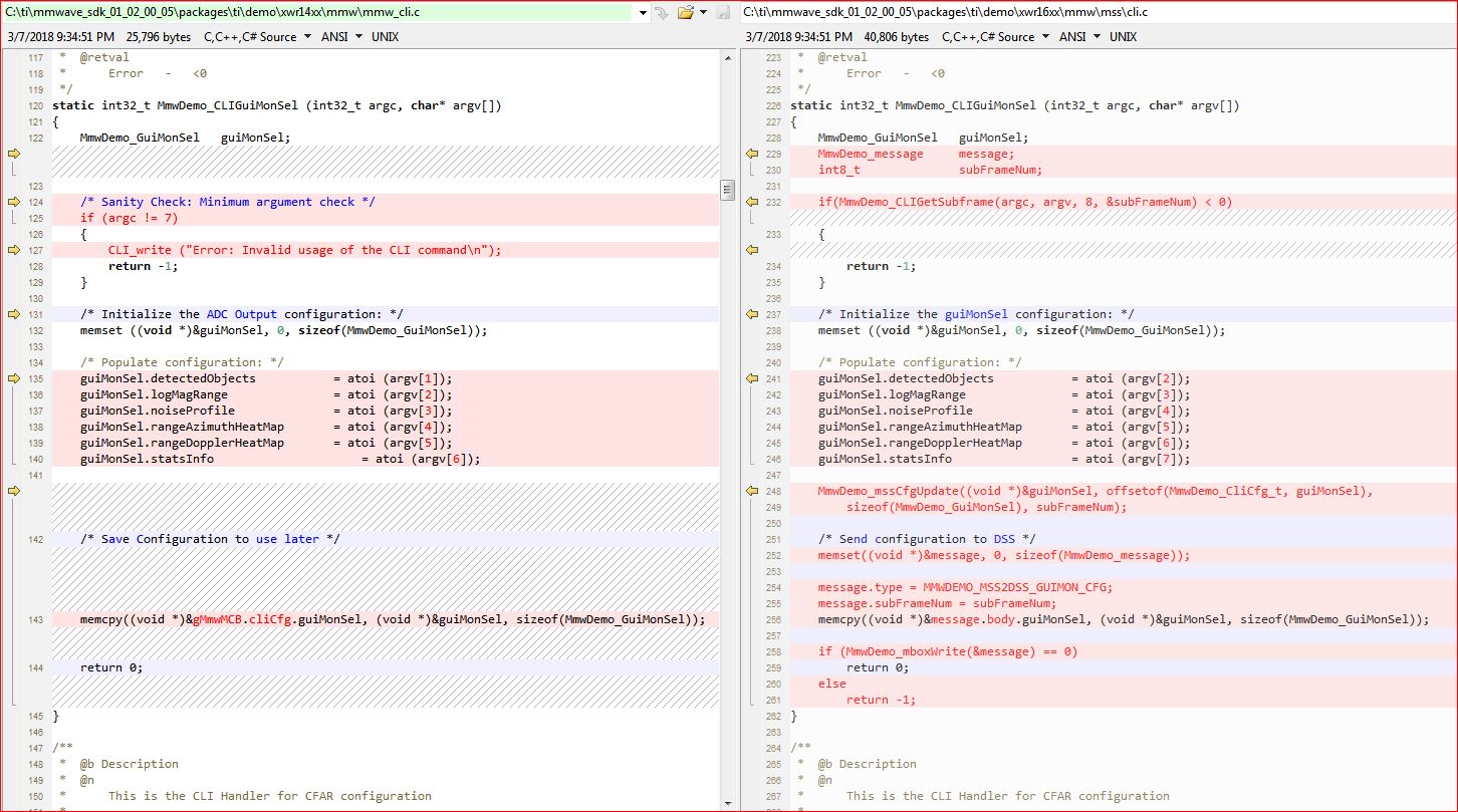

    This is a good sollution but it also costs me a lot of time to figure out how to apply this to the software as I have to modify the datapathtask to remove all the cli commands. Maybe I am going to give it a try in the future. But for now I would like to use the cli method.
    I have been trying to get it to work but no success so far. I found out that in the example I reference to in my first post that they used a mailbox and have at every setting in the cli.c a function called mmwDemo_mboxWrite where they write the settings to, see the piece of code below.

    But when I build this code it seems it cannot finde the mboxwrite function, is this because it is an older function that had been replaced in the newer version? And do I even need he mailbox thing to set all the config parameters?

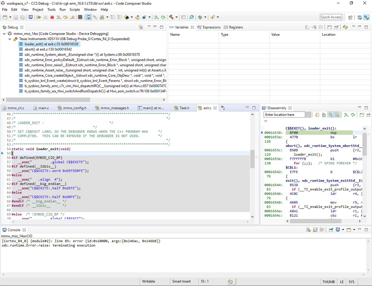

  • I am also trying to figure it out with debugging but the program crashes when it loads. I uploaded a picture of the error.
    If I comment the function MmwDemo_IniRSSDSSCfg() out of the CLIInit function(this is from the reference I used for de CLI commands) then it just loads the program and I can start it. So is the way that they did it in the reference wrong or did I do something wrong? If I need to post more information just let me know.
  • Hi Vera,
    Which EVM are you testing this on, IWR1443BOOST or IWR1642BOOST?
    I ask because your original post is tagged with IWR1443BOOST, but the code you referred to above is from the xwr16xx OOB demo and meant to run on an IWR16xx device/EVM which has the DSS (DSP SubSystem containing the C674x DSP). If you run this on a 1443 device, it would not work as 1443 has only the MSS (R4F core). Please confirm which device you are using.

  • Hi Vera,
    As I mentioned, the code snippet you posted above is from the IWR16xx demo version of the function MmwDemo_CliGuiMonSel. I have attached a snapshot comparing this function between the 14xx and 16xx OOB demos from the latest SDK. You can see that the 14xx function (to the left) does not write to the dss mailbox. I assume that the example code provided by Herman Stubeda in the above thread was for xwr16xx OOB demo.
    You need to replace this function with the 14xx OOB demo equivalent as shown in the snapshot. Please also note that the example shared in the thread you referred to is probably based on mmWave SDK 1.1.0.2 since the latest SDK 1.2.0.5 was note available in Nov 2017. So the easiest way would be to get this code running in the IWR14xx demo from that SDK version and once you have it working with SDK 1.1.0.2, port it to the latest SDK 1.2.0.5 using the migration guide provided in the release notes for the latest SDK.
