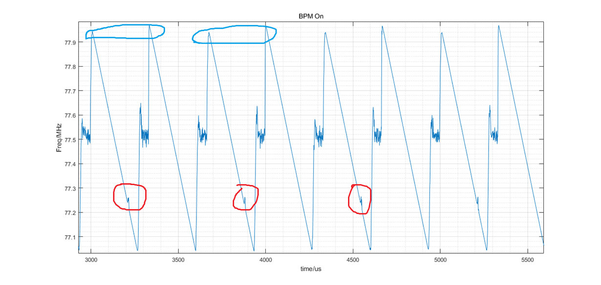

I tested BPM on awr1642 on the AWR1642BOOST EVM. My configure is based on "profile_2d_bpm.cfg" in mmWaveDemo, but I wrote it to static configure.
The code related to bpm is as follows:

I used an Oscilloscope to capture the radio that AWR1642BOOST emitted, but my freq-time plot is as follows:
The red part seems no good, because the frequency is not linear, the blue part of the same chirp has 20MHz lower than the other part. (S1-S2) of BPM seems gonging wrong.

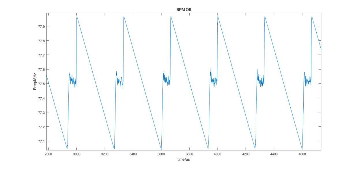

If I don't use BPM, the result acts perfect:
I think something wrong with my BPM, and my configure is referred to "profile_2d_bpm.cfg" in awr1642 demo. Where did I go wrong? thank u!
