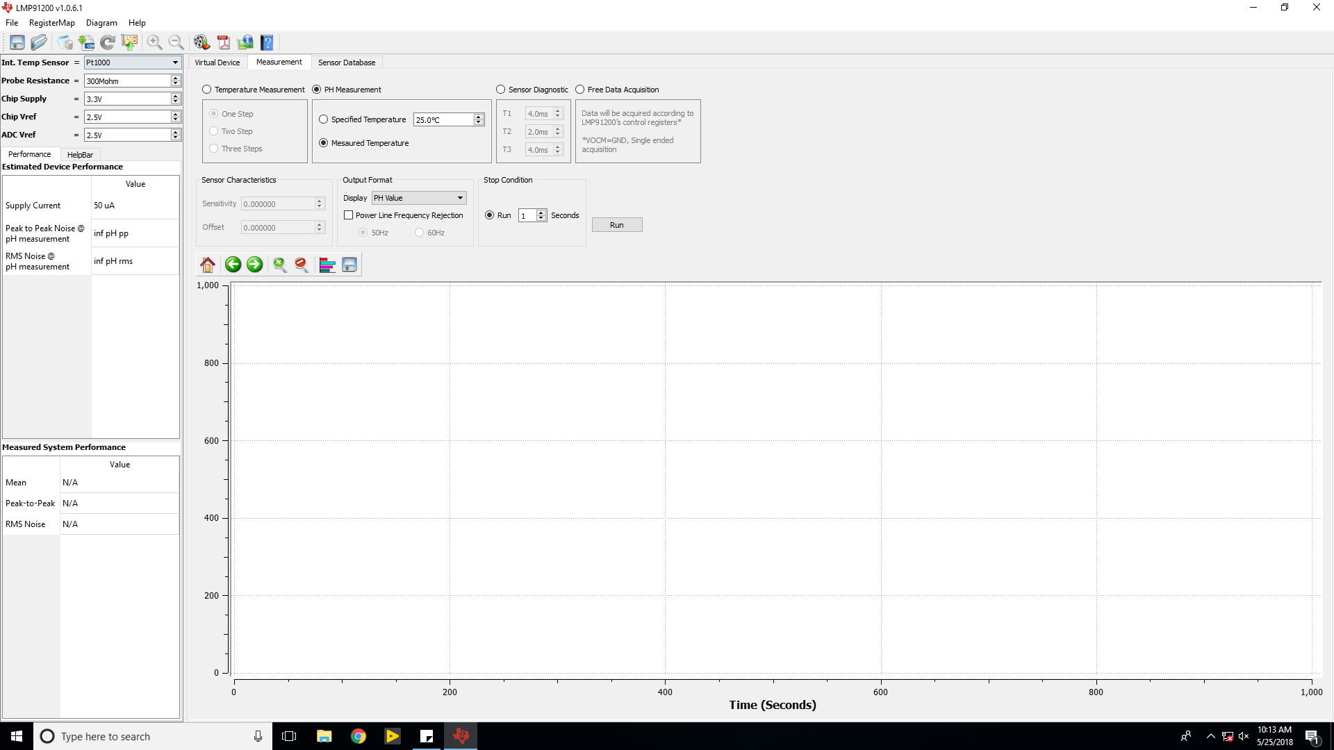

I am currently using the LMP91200 v1.0.6.1 software on Windows 10, and have the LMP91200EVAL board connected to the SPIO-4 board which is connected to my computer via USB. I am using a ph sensor from Accumet (Cat. #13-620-631), which is connected to the LMP91200EVAL board with the BNC connector to measure ph. There is also a stereo plug from the ph meter for temperature output which is not currently connected to the LMP91200EVAL board, so I am not expecting to be able to read the temperature with the current setup, just the ph.
When I run the software to measure ph I get the following error:
"Wait too long for the data, capture will stop. Possible Reason: Transfer size too large."
I get this error message when I have the following settings in the Measurement tab: Ph Measurement, Specified Temperature of 25.0 C, Display PH Value, and Run for 1 second.
If I run the software using the above settings except changing it to use the Measured Temperature I get the following error:
"Wait too long for the data, capture will stop. Possible Reason: Transfer size too small"

    I have attached screenshots of the GUI while running each configuration (before clicking run and the error message I receive). I have also attached a screenshot of the configuration for the custom sensor I am using. I am not exactly sure if the Max_Probe_Resistance or the Int_Temp_Sensor are correct because the documentation I have on the pH sensor does not have this information, but I have tried selecting both types of temperature sensors and a variety of values for the max probe resistance and I always get the same errors. I have also tried selecting many of the given pH sensors in the software and also receive the same error messages. Even if these are not correct shouldn't I at least be getting some reading from the pH sensor even if it is not accurate?

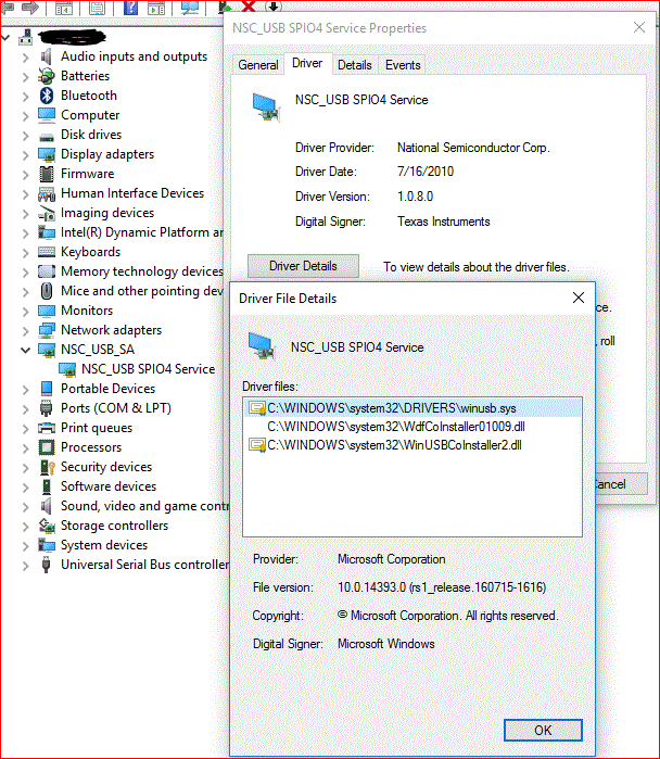

    Thanks for taking those measurements. When you connect only the SPIO-4 EVM to your computer (with LMP91200 EVM not attached), how is it recognized by Windows10? This is what my computer shows
    Dan
  • Dan,
    For some reason we could not get our computer running Windows 10 to recognize the SPIO-4 board today, so we switched to a computer with Windows 7 and are still having the exact same issues.
    Here is how the computer running Windows 7 recognizes it:
    It looks like everything is the same except the file version.
