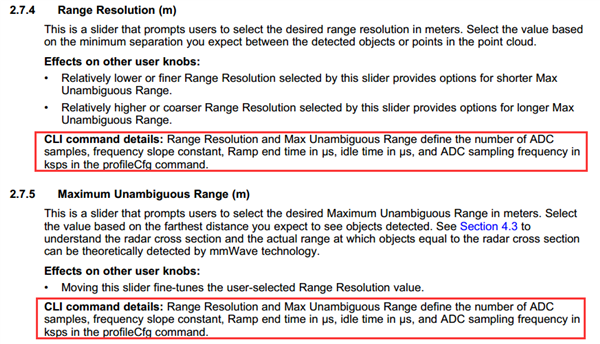

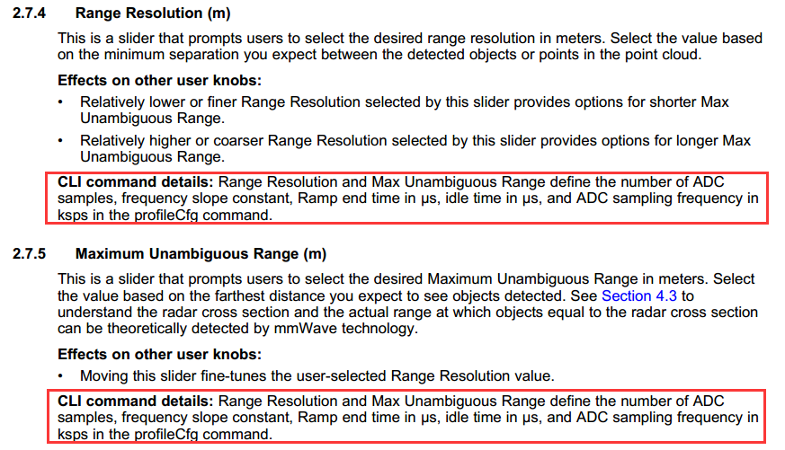

1. I thing the slope of chirp = sweep bandwidth / ramp end time and the sampling rate = samples per chirp / ramp end time according to the above documents, is my understanding correct?
2. I found the CLI command details of 2.7.4 and 2.7.5 on the  MMWave Demo Visualizer User's Guide are the same, does this mean that the rang resolution or  max distance alone cannot determine certain CLI command, which can only be determined when both rang resolution and  max distanc are determined ?

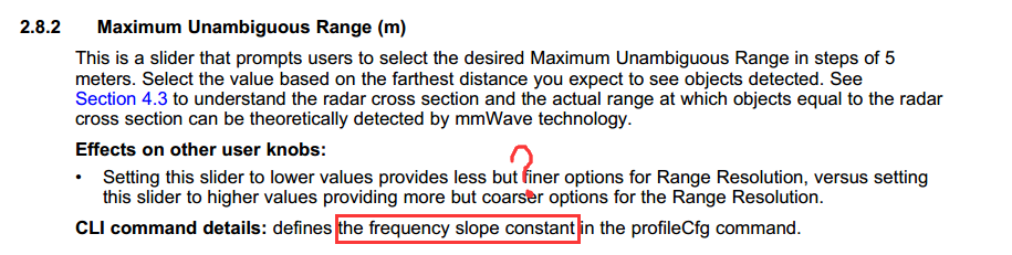

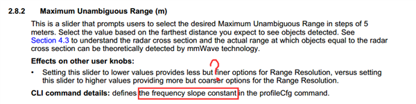

3. On the 2.8.2 of  MMWave Demo Visualizer User's Guide, I can't understand that why max range can defines  the frequency slope constant? Because acording the Programming Chirp Parameters in TI Radar Devices, the max Range = (IF_max*c)/(2S), and  the IF_max is also dependent on the ADC sampling frequency  used, so I think the max range can only determines the value of (IF_max/S) . Can you help me solve my problem?

    2. This is correct for the profileCfg command which defines the ramp parameters. The ramp parameters are determined based on max range, range resolution and velocity as well. Max range alone cannot define the complete ramp configuration since Range resolution determines the total sweep bandwidth. Range resolution is a function of sweep bandwidth and is given by Rres = c/2B where c is the speed of light and B is the sweep bandwidth. So you need to know the range resolution to determine the total bandwidth and hence ramp end time and ramp slope.
    3. For a given sweep bandwidth, slower ramps provide higher maximum range while faster ramps  (i.e. higher slope) provide higher maximum velocity so maximum distance affects ramp slope.
