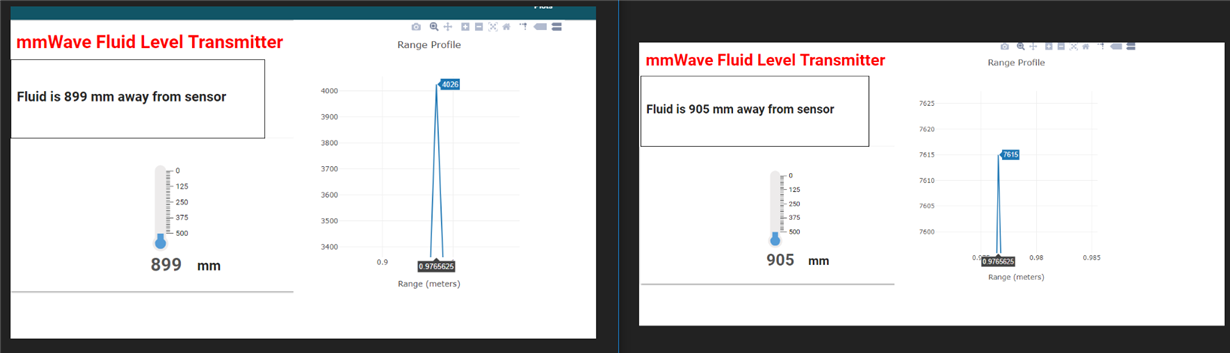

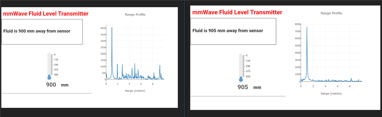

    I did more tests, and find out some new properties that are worth mentioning. The reading of the radar, i.e. fluid is X mm away from the board, could even be varied with both the board and the object being measured fixed in their positions. For example I first measure the distance with just the radar perpendicular to the object. Then I restrict the the radar’s angle of receiving and transmitting em wave, by putting a rectangular or cylindrical carton tube (wrapped with tin foil) perpendicular to the antennae, so that the signal can only go through the tube. When i make a measurement set up like this, I get a different reading, sometimes more accurate than the raw radar reading, sometimes not. But regardless of the set up, as long as the radar and the object are fixed in their position, the value of the peak is always the same, only the readings can be vary. This picture below shows the difference in readings and noise, the graph on the right is the one with the tube.
    the real distance being 901mm. Now its the peak value comparison:

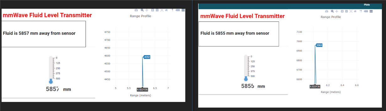

    The readings are exactly the same. Here is one more example:

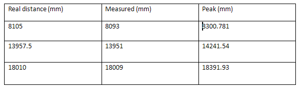

    As you asked, I made a table of three measurements with the tube:
    If there is more information needed, please ask, I can do more experiments.
    Thank you very much and regards, Bang.
    In your example plots, using the shield tube results in a stronger reflected signal, and less other targets detected.
    The distance calculated is based on the radial distance. You may find that the specific use of Tx affects your measurement. Tx3 is closest to the
    Rx, however it has higher leakage to Rx4. If you are using Tx1, and the 4Rx, the measurement is based on Tx1 to the center of Rx2,Rx3. It is a radial distance, unless you have a redesigned card with one Tx and one Rx with a shield in the middle.
    Normally with level gauge there is a linear calibration after the range FFT to process your mm value. There is a (m) slope and intercept (b), if your measurements are repeatable, then the m and b can be used to adjust the measured value.
    There are also optimizations for specific chirp parameters, numadc samples, higher DFE output rate, and number of chirps/frame processed to have a higher integration time, which allows the detection to occur at a longer distance.
