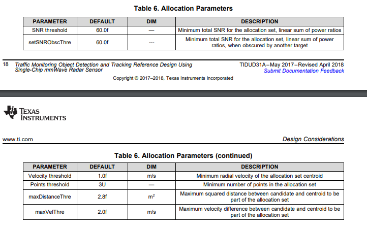

    If detection is still poor on incoming targets after the new demo is downloaded, please try lowering the bolded and underlined values in the configuration:
    allocationParam 30 60 1.0 3 2.8 2.0  These are explained in the people counting customization guide.

    1.allocationParam 30 60 1.0 3 2.8 2.0
    2.allocationParam 20 60 1.0 2 2.8 2.0
    3.allocationParam 10 60 1.0 1 2.8 2.0
    All of above, the result is the same , about close 25m can detect .
    How can I improve the result?
    /Melvin

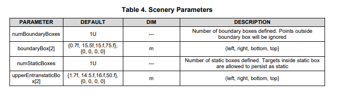

    3. GTrack in traffic monitoring is identical to GTrack in People Counting, save for a few parameters, which I will explain below:
      1. Scenery Parameters – these are completely different from the People Counting parameters, though they fill the same function.  These are described in section 3.3.3.1.1 of the Traffic Monitoring TI Design. The first argument is the number of boundary boxes. Only points within the defined boundary boxes will be considered for tracking. Setting 0 boundary boxes will make all points be considered for tracking. Up to 2 boundary boxes can be defined. The (left, right, bottom, top) arguments should be considered assuming you are standing behind the device, so that you are overlooking the scene the device is overlooking. Then left is you left, right is your right, bottom is your location, and top is the range limit of the device.  The Static box arguments work the same way. An object in the static box will maintain a track even if there are no detection points associated with that track.
      2. Allocation Parameters – These parameters are identical to the People Counting Allocation Parameters, except for one additional parameter.  This is the setSNRObscThre argument. When a cluster of detected points is behind a target that has already been allocated, this is used instead of the SNR threshold (first Allocation parameter). This is used to minimize false detections due to multipath reflections from a target. These multipath reflections will appear directly behind the detected target at about twice the distance. By requiring a different SNR threshold for these targets, we can minimize false detections on these targets.

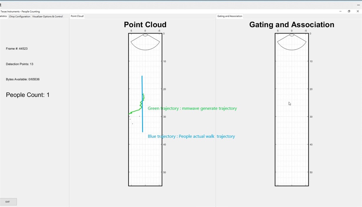

    (2) During below test , I had occur 2 times the tracking trajectory was suddenly offset(frameCfg config is frameCfg 0 1 128 0 33.3 1 0)
         Blue trajectory : People actual walk  trajectory
         Green trajectory : mmwave generate trajectory
    /Melvin

    2. In the picture, it looks like the point cloud is offset, and the tracker is putting the tracked centroid in the middle of those offset points.  I am assuming not all of these points are being generated by the person walking.  When the tracker is placing the centroid, it makes a compromise between the location it predicted the centroid to be at, and the location it measured the centroid to be at. There are values inside the code that can effect how this compromise is made. In task_app.c (mss project), find maxAccelerationX and maxAccelerationY at linees 310 and 311. The smaller these values are, the more the tracker trusts the predicted location (from Kalman filter) and the larger these values are, the more the tracker trusts the measured location. Currently, these values are 2 and 10.  By lowering these (decimal values (0.2) are allowed), you will make the track less likely to behave the way it did on your second example. If you have the fHist saved, you can try the TM_play.exe file, which lets you tune this parameters on already collected data.

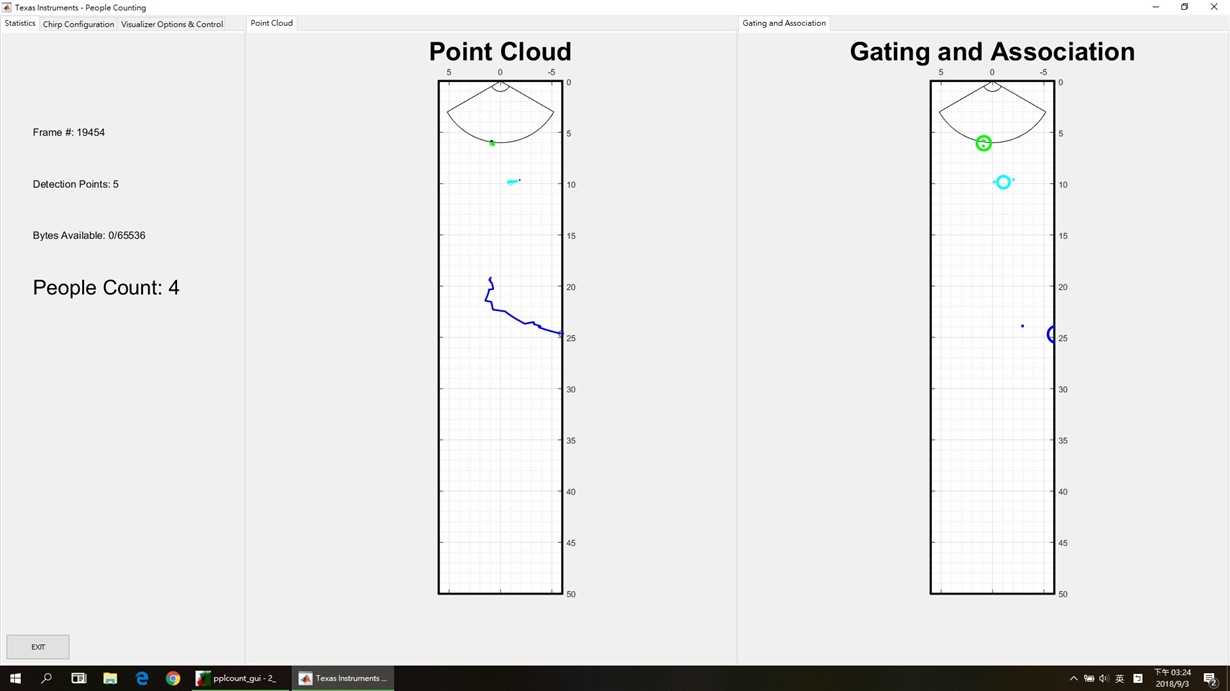

    (1)Walk from 50m to 0m , when people walk close 30m(beter than berfore :25m) can be detect , but detect distance isn't meet our expectation
    (2)Walked straight ,the tracking trajectory was suddenly offset
    (3)People amount incorrect (only one people walk)
    /Melvin

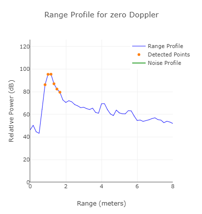

    Do you see detection points at 50m? Do you see detection points at 40m? If not, can you run the Out of Box demo and analyze the range FFT at 10m, 30m, and 50m?  You can use this tool to develop a long range chirp for the OoB demo.
    When someone is at range, you should see a peak at that range. For example, in the picture below, there is a peak at 1m.  You will want to see a peak at each distance you check.

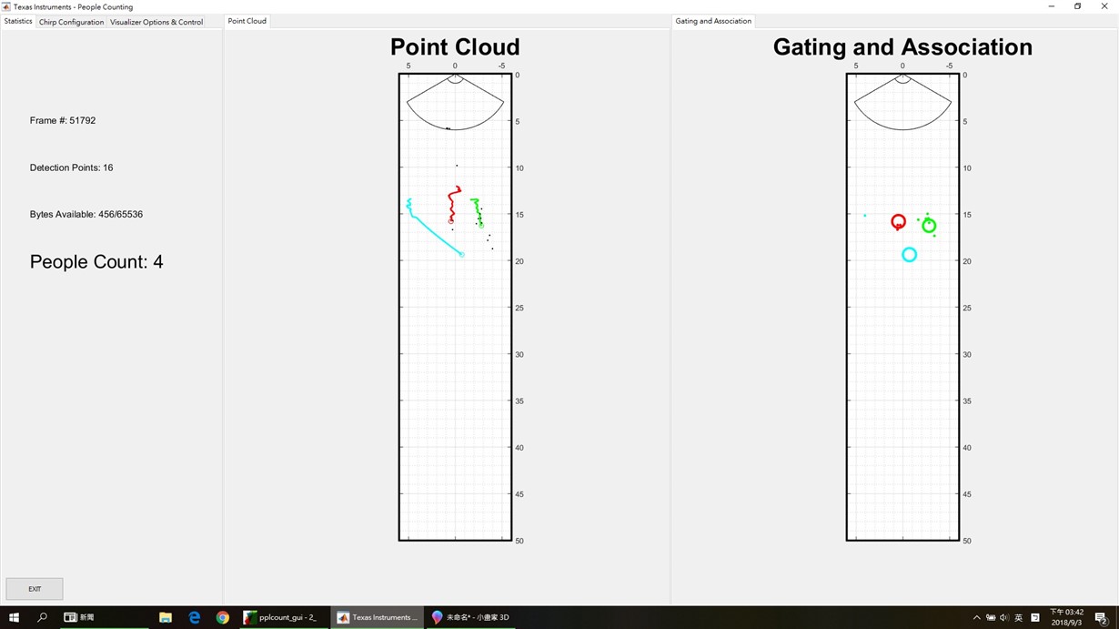

    2. Other question,the confige have more noise point then before confige, So When
    one people walk , sometimes it detect 3 people on gui.
