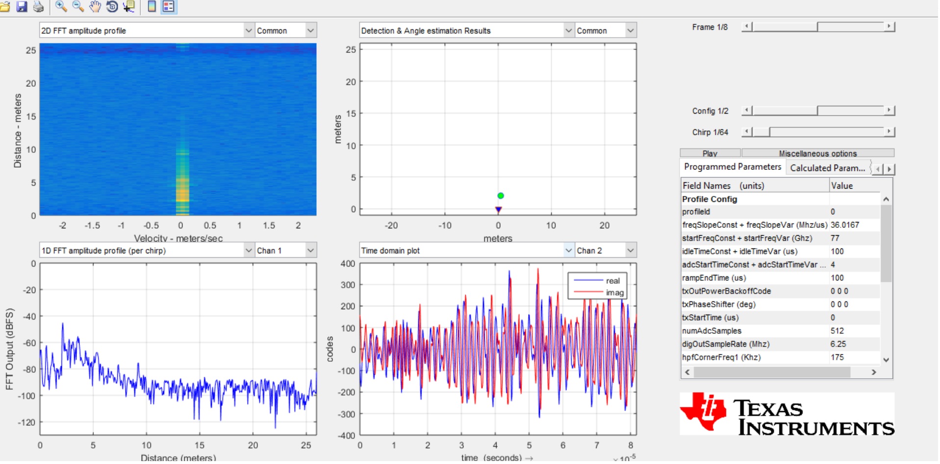

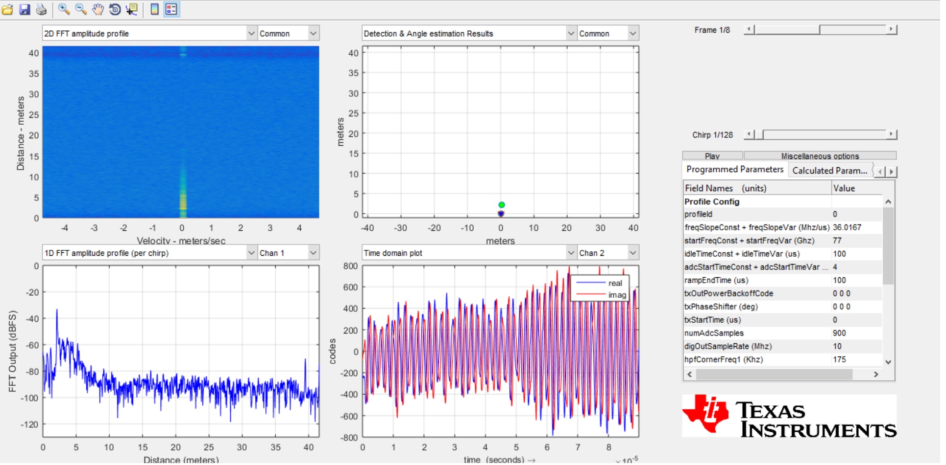

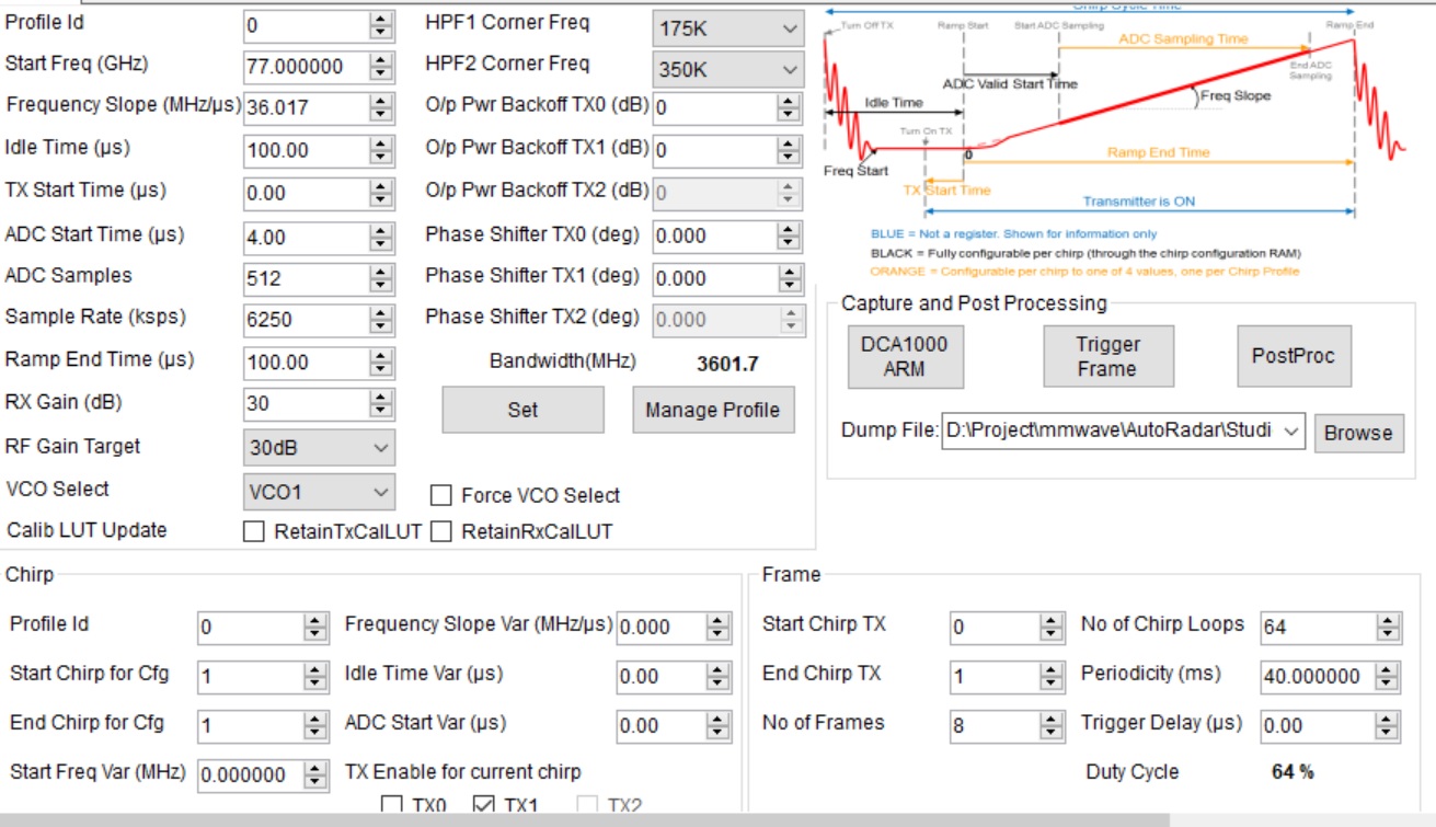

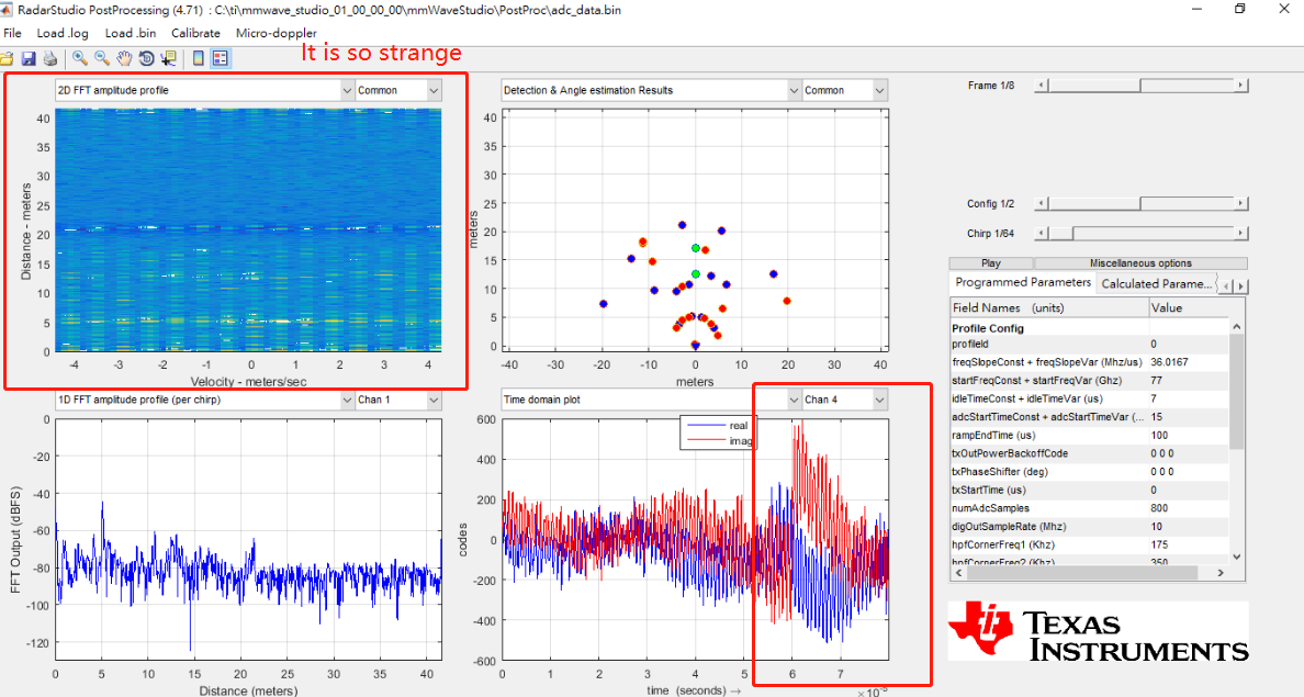

I use DCA1000+AWR1642 to get raw data for analysis.
when adcStarTime=4us, rampEndTime=100us, ADC samples=900, DCA1000 PostPro is as below
I'm not sure that there is a distortion at begining of the data.So I set adcStarTime=24us, rampEndTime=100us, ADC samples=750,DCA1000 PostPro is as below, I repeat the operation and get the same results,that is why? what's wrong with it ? How to avoid getting this?
