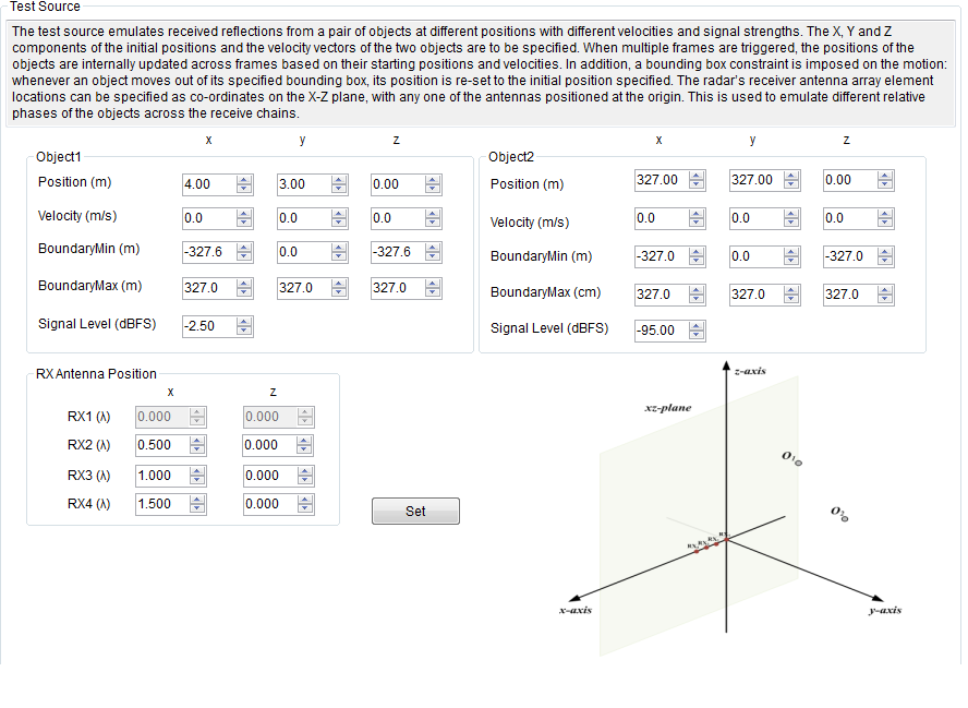

can i use the fix test pattern mode with CSI2 data path?my processor is Zynq UltraScale plus.
In normal mode i can receive data pkg and CP data is correct,Chirp Num is accurately increasing.
in order to verify the data i would like to use test pattern sending fixed data,but No data received,it seems that 1243 does not send any data pkg.
where did i wrong?
I use the following setting:

    With CSI, you will not be able to use the test pattern.
    But you can use the test source to generate a good test pattern data. You can configure the test source to generate an object with 0 velocity.
    The test source pattern will be different across chirps, but it will repeat across frames. So you can configure a small number of chirps if you like.
    An example configuration can be like the following image.
    Anand
  • Hi,Anand
    Thanks very much,i will try the TestSource mode.
