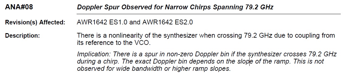

AWR1642BOOST: AWR1642 Device Errata ANA#08
Part Number: AWR1642BOOST
I read this Errata and found issue ANA#08. But I am not sure what exactly will happen. And how to reproduce it?
1. Could you give me a profile setting so that I could reproduce issue ANA#08?
2. Could you tell me what kind of data I could observe the doppler spur when I set this profile? (ex:ADC data or HeatMap data or...)
Thank in advanced.
