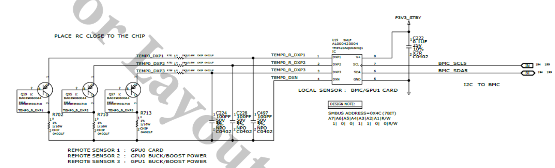

Hi Sir,
Could you please help to check below TMP423 schematic and TMP423 function will work well when BJT on/off?
Schematic
Zoom in part of BTJ circuit

Hi Anne,
Schematic looks ok and aligns with our recommend application diagram with transistors in diode-connected configuration.
I am not sure what you mean by "TMP423 function will work well when BJT on/off?" These BJTs cannot be biased by anything other than the TMP device.
Anne,
The TMP423 will take care of biasing (turning On/Off) the BJT so there is no need to calculate the turning On/Off of the BJT.
