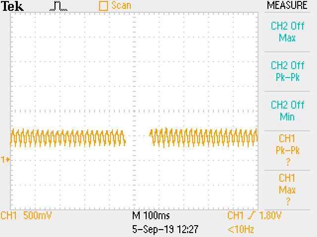

LMP91051: waveform issue
Part Number: LMP91051
Dear Sir/Madam ,
We are working on HTS E21 thermopile sensor with using IR lamo HSL5-115.
I configure below setting.
Lamp Pulse Frequency: 2 Hz( 250ms on and 250ms Off )
System Gain: 2000 V/V( 250 , 8 gain setting in device configure)
System Offset: Apx. -700mV
Input Channel Mux Toggle Frequency: 100hz (after every 10ms switch input mux)
After doing this setting I found below waveform output at out pin.
why this waveform not matched with your reference waveform.?
