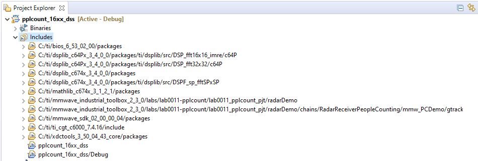

Here is the setup of the project on the CCS:
I am getting all the correct files:
For pplcount_16xx_mss:
xwr16xx_pplcount_lab.bin
xwr16xx_pplcount_mss.bin
xwr16xx_pplcount_mss.xer4f
For pplcount_16xx_dss:
xwr16xx_pplcount_dss.bin
xwr16xx_pplcount_dss.xe674
However, while the rebuild of the pplcount_16xx_mss had finished with no errors, the rebuild of the pplcount_16xx_dss finished with warning about the dss_mmw_linker.cmd.

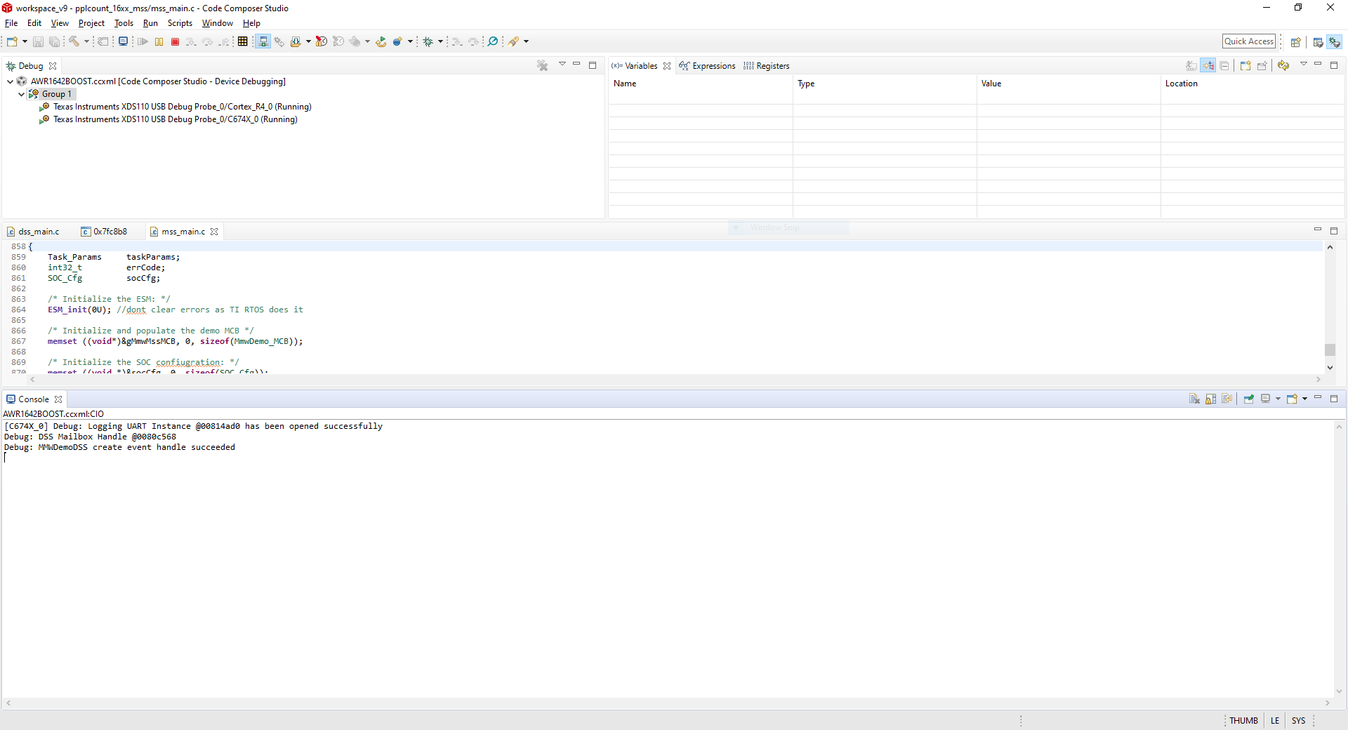

I went flashing the xwr16xx_pplcount_lab.bin and although it finished successfullyI, when I open the tera term I can't get the CLI from COM UART  and can't read any data from COM AUX serial port.
Is the warning of "no matching section" on the dss_mmw_linker.cmd Is the reason for not reading the serial port ? Or is it something else?
Please advise what to do.
Avi

  • Hi Justin,
    Thank you for your reply.
    I checked the jumper, and it's not on flashing mode.
    In addition, I checked the baud rate on both COM ports, and they are correct.
    Here is the snap shot from running the device on debug mode over CCS:
    As you can see, it seems like the program is stuck at the initialized point.
    I am waiting for your further instructions.
    Avi
  • Hi Avi,
    The mss is not doing anything in the screenshot, despite the fact that CCS show that it is running. You should see messages from the MSS that it is syncing with dss, opening uart, and initializing CLI.  The mss is either failing to get into the initialization task, or crashing during initialization.
    I recommend stepping through the MSS boot phase
    1. mss_main.,c - main()
    2. mss_main.c - initialization task()
    main() kicks off the initialization task, so this is essentially stepping the first 100 lines of mss code.

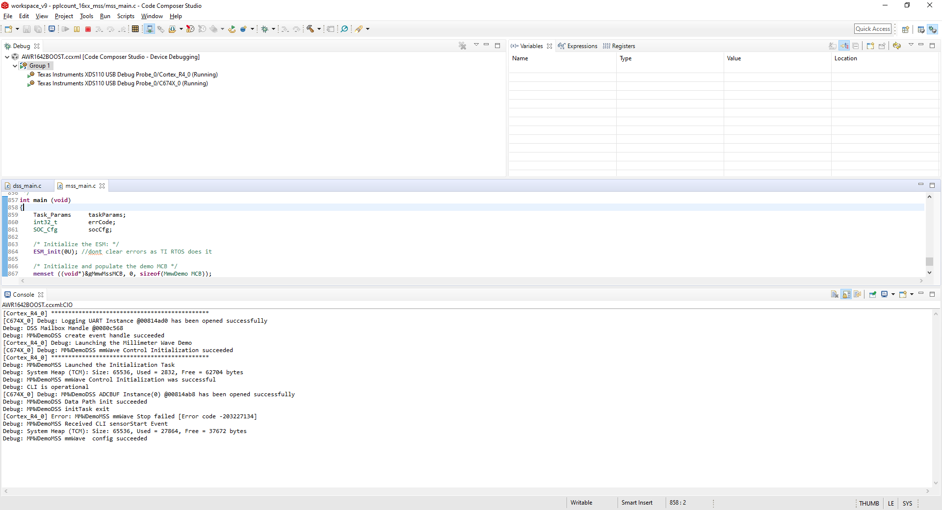

  • Hi Justin,
    I changed the SDK version 01.02.00.05 and now the initialize mode is working.
    Here is the outcome:
    Also as a printout:
    [Cortex_R4_0] **********************************************
    [C674X_0] Debug: Logging UART Instance @00814ad0 has been opened successfully
    Debug: DSS Mailbox Handle @0080c568
    Debug: MMWDemoDSS create event handle succeeded
    [Cortex_R4_0] Debug: Launching the Millimeter Wave Demo
    [C674X_0] Debug: MMWDemoDSS mmWave Control Initialization succeeded
    Debug: MMWDemoMSS Launched the Initialization Task
    Debug: System Heap (TCM): Size: 65536, Used = 2832, Free = 62704 bytes
    Debug: MMWDemoMSS mmWave Control Initialization was successful
    Debug: CLI is operational
    [C674X_0] Debug: MMWDemoDSS ADCBUF Instance(0) @00814ab8 has been opened successfully
    Debug: MMWDemoDSS Data Path init succeeded
    Debug: MMWDemoDSS initTask exit
    [Cortex_R4_0] Error: MMWDemoMSS mmWave Stop failed [Error code -203227134]
    Debug: MMWDemoMSS Received CLI sensorStart Event
    Debug: System Heap (TCM): Size: 65536, Used = 27864, Free = 37672 bytes
    Debug: MMWDemoMSS mmWave config succeeded
    I am waiting for your response.
    Avi
  • Hi Avi,
    This appears to be working from the printout - it looks like the software successfully received the command.
    Justin
  • Hi Justin,
    So if everything is fine and hard configuration is working on CLI port, Then why can't I see the streaming data over the data serial port ?
    I am connecting to both COM ports using Tera Term.
    Avi
  • Hi Avi,
    I see a line indicating that sensor stop failed, which is fine. I also see a sensorStart line. However, I would expect to see a printout when you send trackerCfg. Can you copy the config file you sent here?
    Justin
