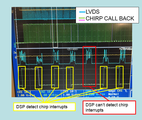

When debugging the timing of an LVDS and DSP chirp interrupt using an oscilloscope, the DSP may not detect the chirp interrupt.
*DSP is processing previousframe data.(Tracking etc.)
I think the MMIC is working properly because the hard-triggered LVDS is working properly.
So, I think there is a problem with SYS / BIOS.
Does the SYS/BIOS become less responsive to interrupts while the DSP is doing something?
Or are there other factors that can make the SYS/BIOS less responsive?

* LVDS operates with a hard trigger and displays the Tx Hi waveform.
* The CHIRP CALL BACK (green and red) is inverted each time the DSP detects a chirp interrupt.

    How do you probe these two interrupts? I guess you are controlling one of GPIO from DSP.
    When you see chirp interrupt (GPIO toggle) missing, within DSS also does it have a mismatch in chirp Interrupt count?

    〇How do you probe these two interrupts? I guess you are controlling one of GPIO from DSP.
         Yes.
        I operate GIO from DSP and switch High/Low of GPIO.
     GPIO control is switching GPIO_0 High / Low every time the Chirp callback function is called. In addition, every time the callback function completes, it switches High / Low of GPIO_1.
    〇When you see chirp interrupt (GPIO toggle) missing, within DSS also does it have a mismatch in chirp Interrupt count?
    →Yes.
       If the chirp interrupt is missing, the chirp count in DSS is less than the set value.

    I tried the content in the your reply.
    The result was that MSS detected an interrupt, but DSS did not.
    From this result, it seems that interrupts are temporarily disabled in the DSS BIOS.
    Do you have any idea why the interrupt stops?

  • Hello Jitendra,
    The green waveform is the GPIO_21 waveform controlled from the DSS.
    The control contents of this GPIO are the same as before, switching High / Low each time the chirp callback function is called.
    The reason for controlling the GPIO from the DSS is that you do not know when the DSS misses the chirp interrupt. In other words, if you do not monitor the DSS, you will not know where you missed the interrupt.
    The red waveform is the waveform measured on GPIO_0 using the content of your reply. Therefore, I recognize that this waveform is synchronized with the interrupt detected by MSS.

  • Hello Jitendra,
    The measurement was performed with the following settings.
    -All GPIO control from DSS is invalid.
    -Set to synchronize GPIO_0 with ADC_VALID from MSS.
    As a result, GPIO_0 had no problem, but the DSS chirp interrupt counter is less than the specified number. Therefore, it is considered that the DSS missed the interrupt.

  • Hello Jitendra,
    BSS is operated by soft trigger.
    External trigger is received by MSS. MSS calls rlSensorStart () when receiving an external trigger.
    So, rlSetFrameConfig API is set to soft trigger.
    The external  trigger timing when a problem occurs is later than the frame time set in BSS.
    * The frame time set in BSS differs from the DSS processing cycle time. The DSS frame processing time is set longer than the BSS frame time.
    Therefore, BSS detects the soft trigger from MSS, and the radio wave emits Sample and Chirp as specified.
    This is consistent with the result that the ADC_VALID measured in the previous MSS is normal, but the DSS missed the chirp interrupt.
