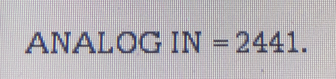

We have been programming on the TI N-spire and were wondering what units the output from the analog.in (from the LM19) is. Is it in milliVolts?

Dear Zoe -
The output of the LM19 is in millivolts.
The range is from ~2.5VDC (or 2500mV) (@~-55C) to ~300mV at ~130C.
See page 2 of the datasheet. http://www.ti.com/lit/ds/symlink/lm19.pdf
and the API is here ==> https://education.ti.com/html/webhelp/EG_Innovator/EN/content/eg_innovsys/m_hub-comm/send-read/analog_in.HTML
which indicates that the answer to your question is that the return is the output of the ADC.
