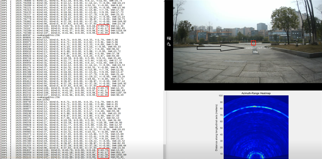

I tried to add data output such as target distance by serial port into the AlgorithmFxn_RadarDspAoaProcess() function of radardspcascademimoaoa_priv.c:
The parameters I used are as follows:
However, in this case, the angular reflector can only be stably detected within 20 meters, and can hardly be detected after 30 meters:
Is there something I didn't do right? What should I do to solve this problem?
