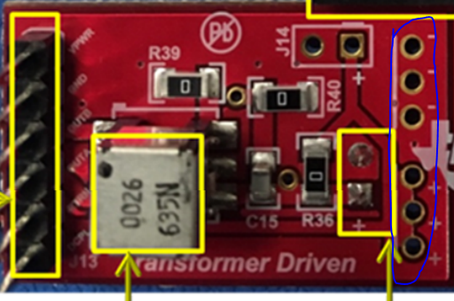

Can i use this pins to connect the transducer ?
  • Hi Alex,
    Yes, the six holes at the right in your image are for the transducer connection. The "+" holes are for the positive terminal of the transducer where the driver/receiver signal goes, and the "-" holes are for the negative terminal of the transducer that goes to ground.
