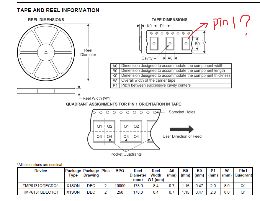

For TMP6131QDYATQ1 (0602) and 0402 package, it's really very hard to distinguish positive and negative cause it's so small. Any approaches to distinguish from package carrier?

Dear Dongbao -
in the image you posted, there is a table which indicates pin 1 is in quadrant Q1 and in the diagram, quadrant Q1 is closest to the sprocket holes, yielding the answer you are looking for.
