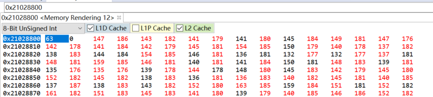

Since the current version does not support CLI related commands of CQ, the customer added the following configuration in the demo program:
SigImg Monitoring config
And call rlRfAnaMonConfig to enable RX_SIG_IMG_BAND_MONITORING.
Other parameters are configured as follows:
adcCfg 2 2
adcbufCfg -1 0 1 1 1
profileCfg 0 76 7.68 6 47 0 0 20.75 1 512 12500 2 0 116
He changed the chrip slope from 20.75Mhz/us to 10.75Mhz/us and observed the following phenomena:
20.75Mhz/us
10.75Mhz/us
The value of the signal band is significantly reduced (actual value = -0.5 * measured value), and some values are lower than the image band.
Customer could like to know when the chrip slope is low, are there other ways to increase the detection energy of the signal band?
