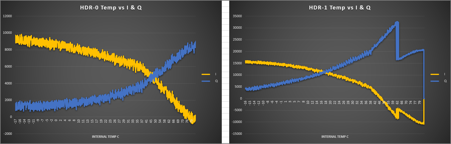

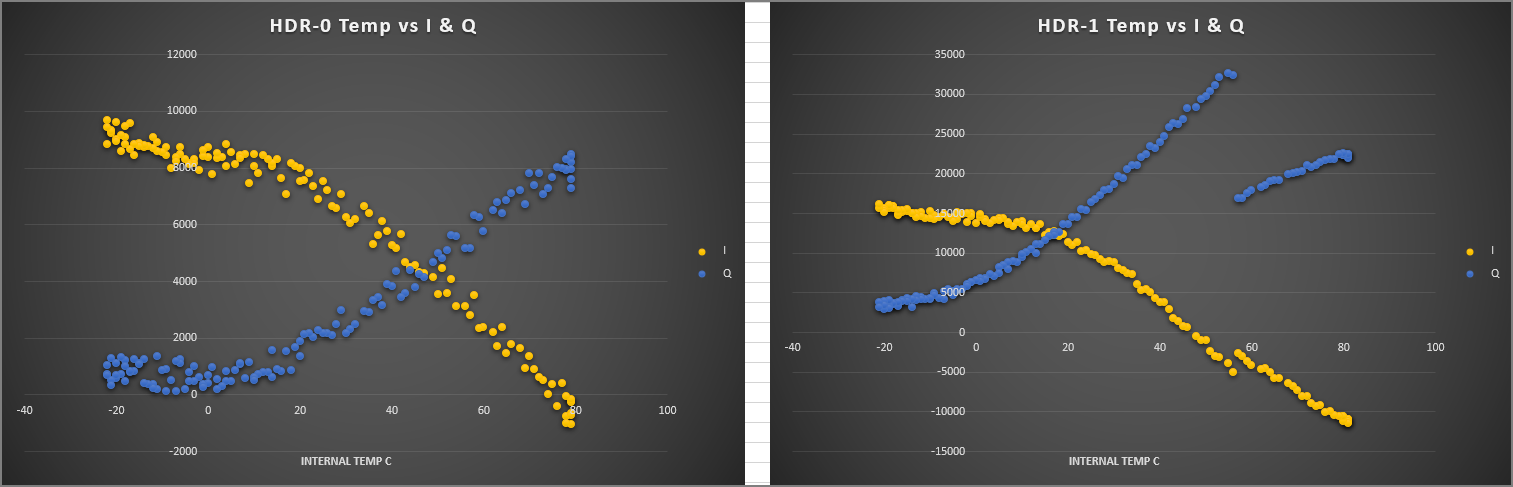

Question 2: In perDesignCalibrationCrosstalk HDR = 1 test results, I see I and Q value suddenly jump at 60C and then continue as temperature increases (image below). Is this normal?
