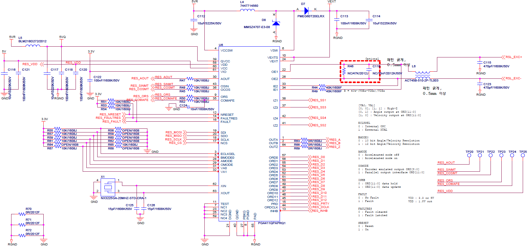

  • Hi Jung,
    Everything looks normal to me. It needs to be debugged further.
    Can you send me the schematic for a review? Please capture OSIN and OCOS signals and send the screenshot.

  • Hi Sharath,
    I send you the schematic and OSIN signal.
    CH1 is excitation voltage, CH2 is voltage between IZ 2 and IZ 4, and CH3 is OSIN output voltage.
    Jung.
    Everything looks normal to me. It is enough if the device is in Normal mode and OMODE=1 for the signals to appear on ORD pins. Is the angle reading from SPI working fine? Is this observed on multiple boards?

  • Hi Jung,
    Everything looks normal to me from the PGA411 setup side. I am not sure why it is being pulled low. I suspect something is wrong from the board side. Can you order an EVM and test to make sure you are matching with the EVM result?
    Sharath
