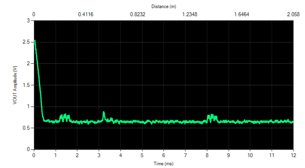

    I have some issues with the 1MHz at the smaller pool, these are the measurements using 1MHz transducer where the Shunts are located at C1 and C12 (which suits the requirements of 1MHz from the lookup table):

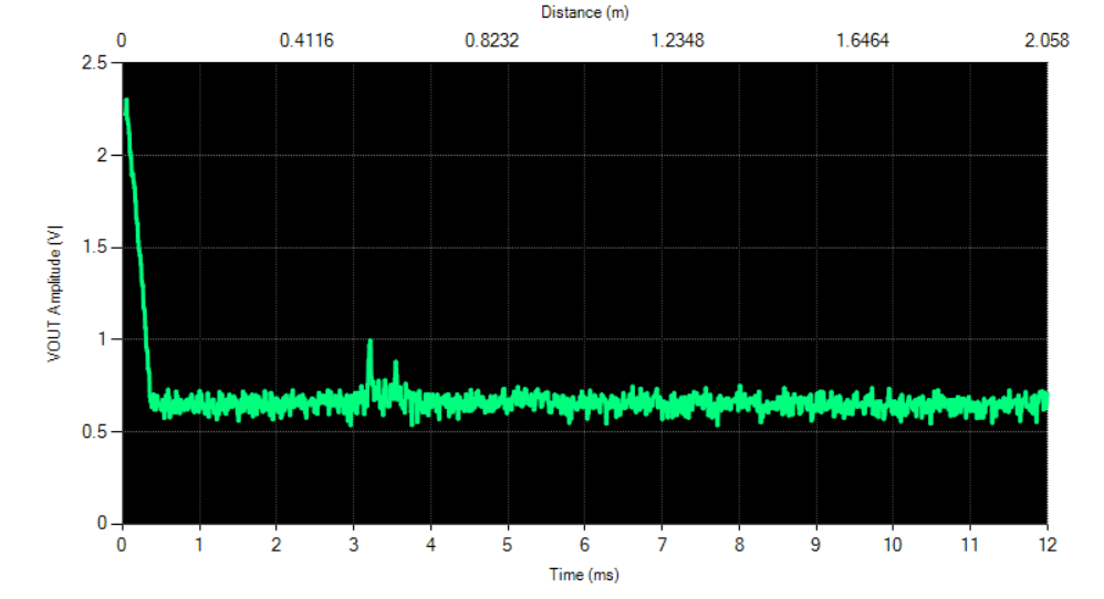

    These are the measurements from with SHUNTS located at C3 and C14:
    Same frequency but as you can see the C3 and C14 looks much better.

  • Hi Itamar,
    The performance differences in the shunts is due to the difference in the amount of high pass filtering. In your second plot, the HPF is more aggressive, so the overall signal appears cleaner, but you'll notice the peak amplitude of your actual echo is also weaker, so there are tradeoffs to consider. If you are satisfied with the results of your C3 and C14 shunt configuration, there is no issue in proceeding with this option.
