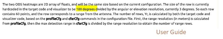

Dear Team,
there are two different statements about the FoVs of the Obstacle Detection Reference Design Using 77-GHz
mmWave Sensor.  I have attached the affected text passages as screenshots.
The associated white paper "TIDEP-0104" describes the FoV with  ±70 degrees in azimuth and ±40 degrees in elevation.
But in the corresponding user guide in the Resource Explorer the FOV is described with ±90 degrees in azimuth, I cannot find any information about elevation.
Which of the two values is correct? Or is the FOV 180 degrees in elevation in the GUI output only for less complex calculations?
