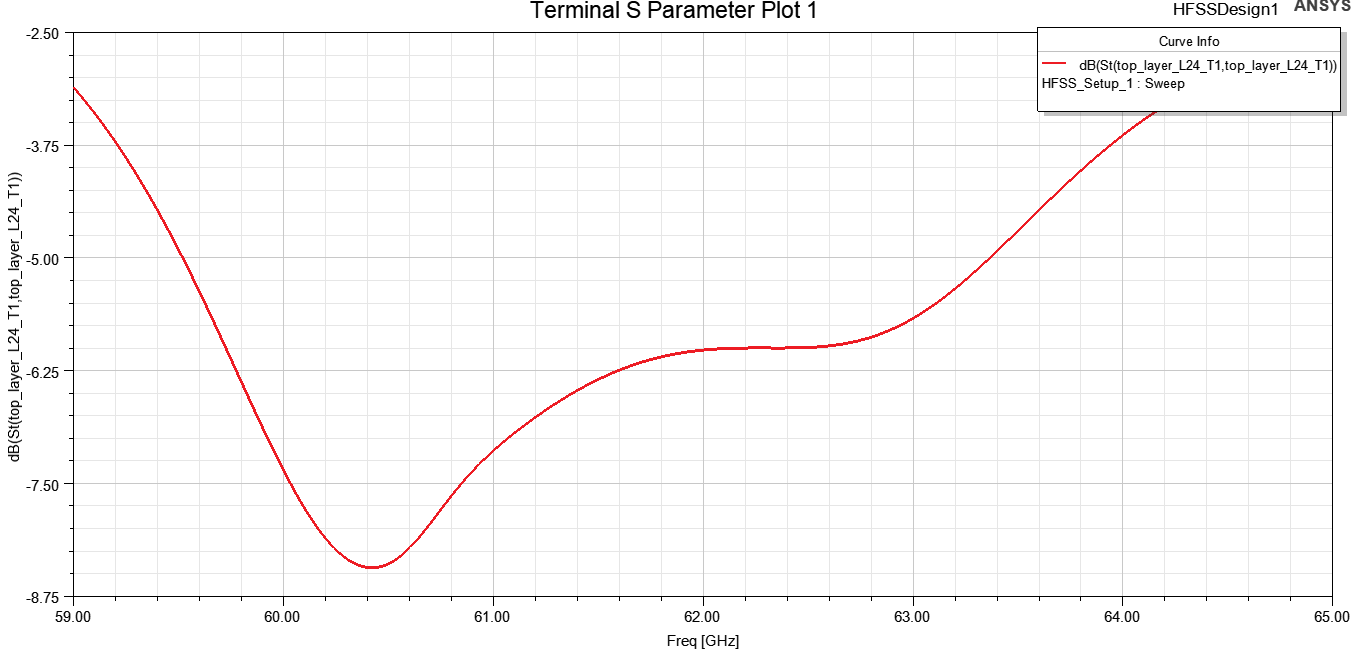

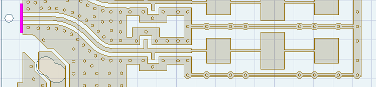

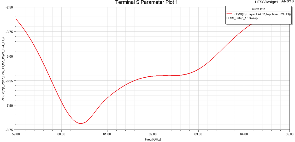

Hi all,
I would like to redesign the antenna on IWR6843ISK board. Before I do that, I simulate the antenna (1by3, including the RF trace and matching network - shunt stub). However, the S11 is way off (even worse) from the threat posted  before :
e2e.ti.com/.../749295
I would like to know if I'm using the wrong parameters, or there is a new version released. My parameters are listed below:
Software: HFSS. Geometry is imported from Altium Designer to HFSS. DK: 3.55. DF: 0.0037 (based on Rogers datasheet).
