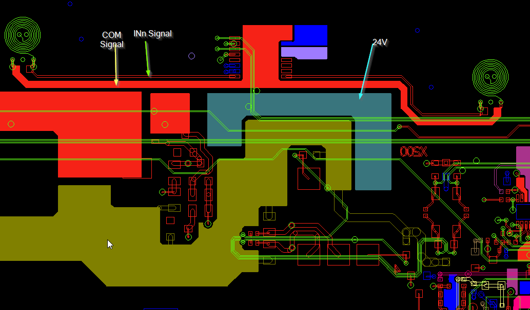

in the last days we got some troubles with our coil system at the emc tests.
We did get some fales press events in our button system.
I suspect we have already found a mistake. This concers about the routing of the com and IN signals. I think we should root the signals like this example.
Because we are close to the supply voltage with our signals and the com and INn signals are rooted parallel.
Can you confirm it this way?

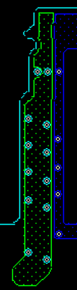

Furthermore I have a question to the coil shielding.
Which signal should I use for the shielding?
Can I use the ground potential or should I am using the com signal?
Which would you prever?

  • Hello Simon,
    You are correct. Having a high voltage plane close to the COM signal can create additional parasitic capacitance between the two and it would be better to put a little more space between those two.
    In regards to the shielding, use the COM plane shielding in your picture 2 for the LDC2112. The GND plane shielding is a general recommendation that applies to all devices but since the LDC211x contains the COM plane, it is recommended to use that for shielding instead. You can also have the COM plane surround the sensor coil but make sure there is a gap of at least 30% of the coil diameter around the coil.

  • Hello Justin,
    I have one more question to the layout.
    Is it better to set vias at regular intervals for the COM line?
    Furthermore, do you have suggestions in which interval we have to set the vias?
    Or is it okay if we have two vias at the beginning and endig of the line?
    Thank you.
    Best regards
    Simon
  • Hello Simon,
