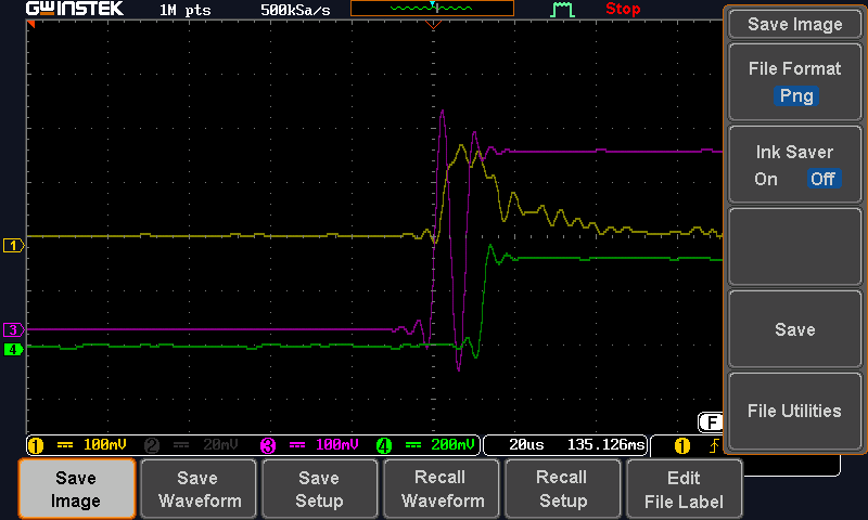

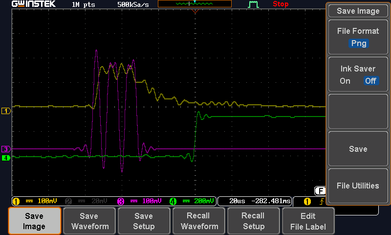

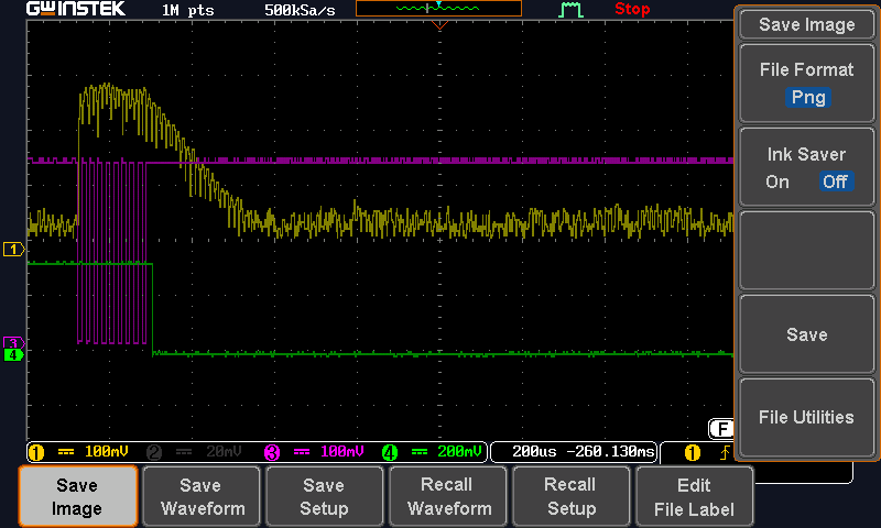

BOOSTXL-TUSS4470: sampling does not capture full envelope
Part Number: BOOSTXL-TUSS4470
Other Parts Discussed in Thread: ENERGIA, , TUSS4470
     I'm writing a program in Code Composer Studio for the MSP430-F5529 to pulse the StemInc SMD15T21R111WL transducer at 1MHz for liquid level measurement and sample the result with the ADC12 module of the MSP430.  The transducer is attached to a BOOSTXL-TUSS4470 and the pulse and sampling code is based on the Energia example for the BOOSTXL-TUSS4470.  I ported the function burstBitBang from TUSS44x0_Ultrasonic.cpp, but the ported code does not start the sampling process soon enough to capture the entire envelope.  I tested this transducer at 1MHz with the TUSS44x0 EVM GUI and the full envelope is displayed.  My first coding attempt was to begin sampling immediately after the pulses are sent, but the TUSS4470 envelope from VOUT is halfway finished before the sampling process begins (see photo 1)  Another attempt was to start the sampling process before pulses are sent to the transducer.  This also does not begin quickly enough (photo 2).  I also attempted to start conversion immediately after the pulses using a single register level command, ADC12SC to reduce the code overhead of Driver Library but this did not noticeably improve the sample start time.  Are there any examples that demonstrate how the EVM GUI captures the full output envelope of a 1 MHz transducer?  The code I wrote is included below.  Thanks for any feedback or ideas,
John
Photo 1: start conversion after bitBang
purple: pulses
yellow: VOUT envelope
green: sample start
Photo 2 : start conversion before bitBang

  • Hi John,
    We do not have any other code examples besides the Energia code example. Can you measure the time it takes from when a sample conversion is first triggered to when you actually get the results? If you find that this time is relatively large, you can try to increase the clock frequency of the ADC clock or reducing the selected sample time if feasible.
    Based on this measured time, you can also try triggering the ADC and then delaying the pulse generation so that the ADC is able to begin sampling at the desired point in time.
    Mekre
  • Hi Mekre,
         I ran the additional tests you described: the time between the sample conversion trigger and the first ADC12MEM0 value is 38 microseconds if sampling begins after the pulses.  If sampling begins before the pulses, this time period is increased to 55 microseconds.  It's possible this increase is a result of the intervening pulses slowing down the conversion time.  In the Energia code example, the sampling occurs after the pulses.  An image of the oscilliscope output is shown below that shows a similar sampling delay.  In the photos I posted above, there is a 1-2 microsecond delay between the first pulse (purple) and the start of the envelope (yellow).  This suggests there is not enough time to begin sampling after the pulses are sent.  From the MSP430 User guide section 28.2.5.3, I calculated the minimum required sample time is 16 cycles at 4 MHz, for a total cycle count of at least 16 sample cycles + 13 conversion cycles or 7.25 microseconds.
    I tested sampling before the pulses are sent by adding a short delay (not shown in code) after conversion start on line 256. This had the unintended result of completing all 125 samples before any pulses were sent, possibly because the higher priority ADC12 interrupt prevents control from returning to the calling function.  The SMCLK is set to 4 MHz and is the clock source for the ADC12 with a cycle time of 0.25 microseconds.  I originally set SMCLK to 8 MHz but it caused I2C communication to stop working.  The TUSS4470 is described to support 1 MHz transducer and the tests I performed using the EVM GUI confirmed this hardware combination can produce accurate water level measurements, so it should be possible to reproduce this ability with code.  Thanks for your suggestions,
    John
    Energia example oscilliscope output : 25 uS burst period (40 Khz), 8 pulses
    purple = bitBang pulses to TUSS4470 pin 40 a.k.a IO2
    yellow = VOUT envelope
    green = ADC12 capture start
  • Hi John,
    You can also try the following:
    • Increasing the CPU clock frequency from 4 MHz to 25 MHz to reduce latency.
    • Use the DMA to transfer samples to memory directly instead of using an interrupt.
    • Enable compiler optimizations in the project settings. You would want to select the option to prioritize speed vs. size for the compiler optimizations.
    For the test you performed where you ended up completing all 125 samples before any pulses were sent, could you increase the number of samples collected from 125 to a larger number? You can always throw away any of the samples you don’t need later.
    Mekre
  • Hi Mekre,
        Thanks for the great ideas to improve speed and efficiency. These should help shorten the time between the end of the purple pulse line and the start of the green sampling. Using DMA may also help with improving the sampling rate and also reduce the length of time to the first sample. You suggested to increase the number of samples.  I'll test again, but from the result of my first test, it seems that any number of samples will always complete before the pulses are sent because of the ADC12 interrupt priority. I am also researching the use of timer based PWM to send pulses to the TUSS4470 IO2 pin (MSP430 pin 2.5) automatically without the use of the main cpu or interrupts. This could allow the timer/pulses to be triggered when the first sample is received and allow sample start to precede the pulses and envelope. It may be difficult to set up the timer correctly, but it seems possible.
    John
