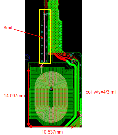

         d. Increase trace width can reduce parasitics? Below picture is present layout, trace width is 8mil, so should we increase it as large as possible?
         e. Since we will add ground shielding to isolate radiation(below picture area 14.097x10.537), adding this will effect f, Q and Rp? If yes, how do we calculated them?

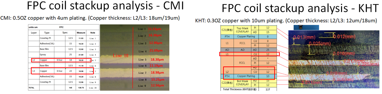

  • Hi John:
    Since there is big different between FPC vendor CMI and KHT, KHT has better performance as below
    We check their stack up as below, their two layer thickness is different, CMI is 18/19 and KHT is 12/18
    Since top side is facing PCB(MCU) and bot side is facing metal, is it possible KHT it's layer facing PCB is much thinner than CMI so MCU radiation effect is smaller than CMI?
    Thank you~~
