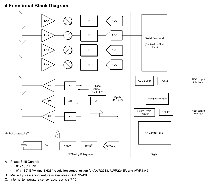

Regarding my first question, I still wanted to know the reason. https://e2e.ti.com/support/sensors/f/1023/t/975532#pi320995filter=answers&pi320995scroll=false
Here is the block diagram from the data sheet.
Is the Phase-Shifter too slow? Im wondering, because why else would TI not implement this functionality?
