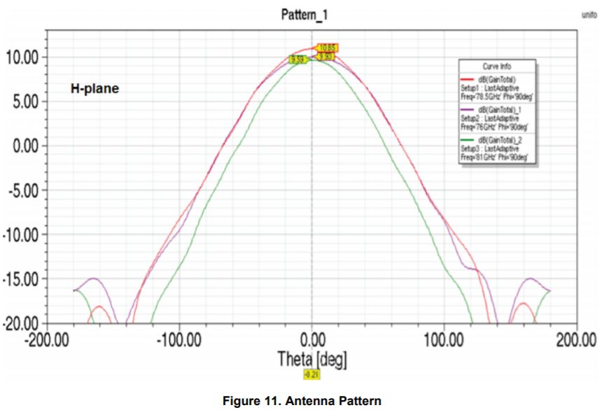

    (1) Based on the requirements, max range, max velocity, range resolution, etc, both labs have defined particular chirp parameters used in "mmr_config_chirp_design_USRRxx.h". However, in the tutorial it also claimed the field of view in Azimuth and Elevation plane. For example, FoV of Azimuth from -50 degree to +50 degree, FoV of Elevation from -15 degree to +15 degree (reference: TIDEP-01011). In the demo code, mmr_18xx_dss and mmr_18xx_mss, where can I define those FoV for the Azimuth and Elevation plane? I am using mmWave SDK 3.5 and mmWave automotive toolbox 3.2.0.
    [Answer] The FOV is a characteristic of the antenna. It is not configured in sw. Please see the EVM UG to see the Antenna Radiation Pattern

    For (1), I understand that the max FoV is from -90 to +90, because d = lamda/2. In the labs, for example, the parking lab, it claimed the FoV is from -50 to +50 (TIDEP-01011). Do you mean it shows the detection from -50 to +50, but the radar scans from -90 to +90? I know the equation for angle resolution in the azimuth plane, basically it depends on the number of rx antennas and d. Could you let me know how can I calculate the angle resolution in the elevation plane?

    1. The advertised angle is limited because the transmit antenna does not illuminate the objects as well if they are at angles(source). Due to this, the reflected signal of an object outside +-50 degrees might not be strong enough to be detected. As Cesar mentioned, this has to do with antenna design rather than the theoretical limit imposed by the angle estimation technique (which is indeed +-90 degrees for our antenna geometry)
    For the 1843 EVM, there are 8 virtual azimuth antennas and 4 virtual elevation antennas. You can use these to calculate the respective resolution.
